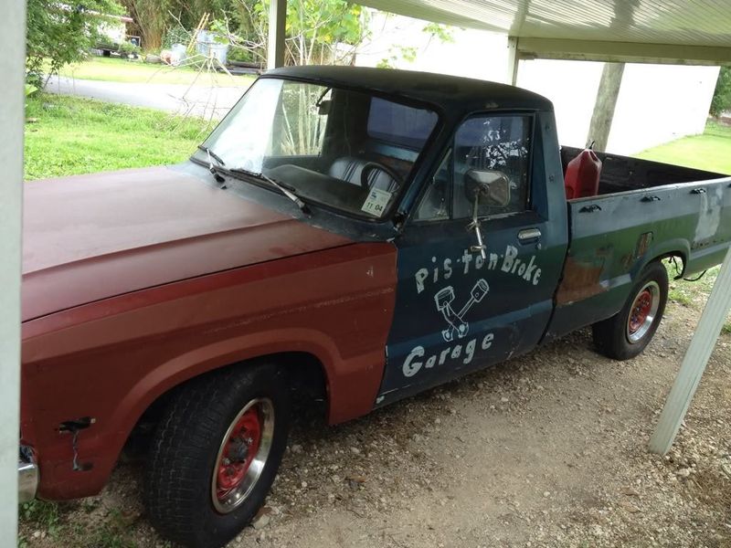

i have a 87b2000 and im trying to find a set of wheels that go with the rat rod look. (beauty ring/baby moons/white walls) i cant seem to find a 6lug similar to this that will fit. what car rim do i need to be looking for that will fit my mazda? i would like to stay under 16"

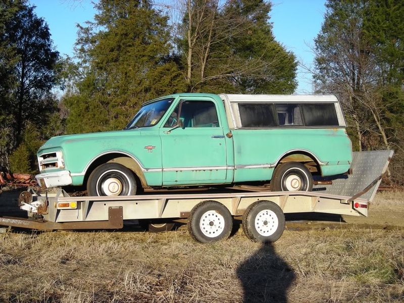

The stock wheels off of a 1960-1970 Chevrolet/GMC 1/2 ton truck should suit you. (in 71 they went to 5 lug on 2wds, but 4wds still had 6 lug). They are simple steel 6x5.5" 15x5.5" wheels and will accept beauty rings/baby moons.
Here are the wheels on my 67 with the original dog dish caps
Only shot I have with the caps off
