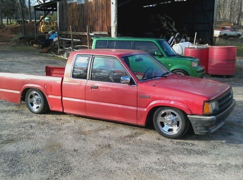

I like my early 90s Mitsubishi Montero 15s.
I needed hub center rings, and mag style lugs to make them fit.
I think the 215/65 r 15 tires would rub if I lowered more than the current 2".
