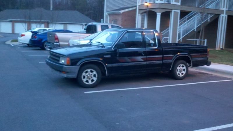

This is how it sits with the 205/80R16s on there
And with the stock size 205/75R14s for reference

ok thats what i thought someone is sellin some h3 wheels with those tires on them and i want to go a bit beefyer but was not sure is you truck lifted with those tires?
