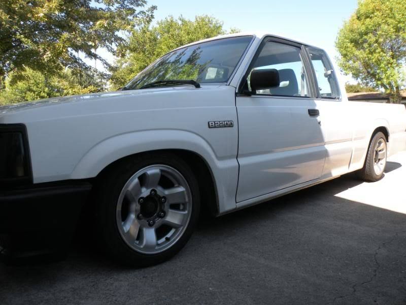

i'm looking to get another set of wheels and i was hoping someone from here could tell me if these will fit on a bagged b2200? lug pattern is right, but if the backspacing good?

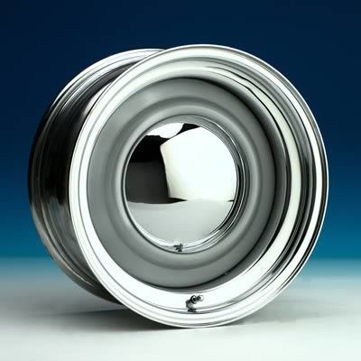

wow, lol i was so tired last night i forgot to post a link up. anyways these are the wheels i'm wondering about.

hard to tell, my old yotas were 15 x 7, +15 and were close to being flush on the rears when I had a 2WD bed. what rims are you running now? the smoothies you're looking are 16 x 7, +12 offset (4" backspace)

right now it has some chrome escalades, which i love but id like something else to change it everynow and then.

if you're running 17" escalades (17 x 7.5, +31) all the calculations show the rims you want stick out aboot 1/2" more than those

thanks for the help so far guys. so do you think these would work then?
