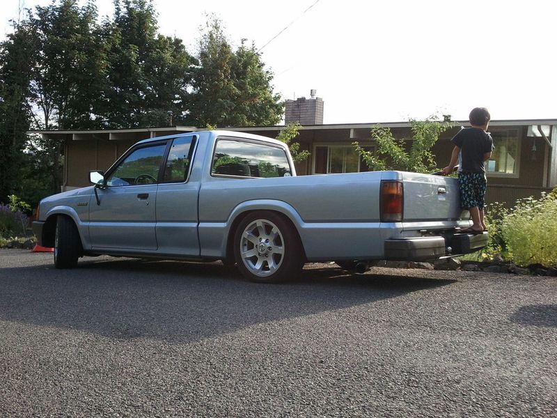

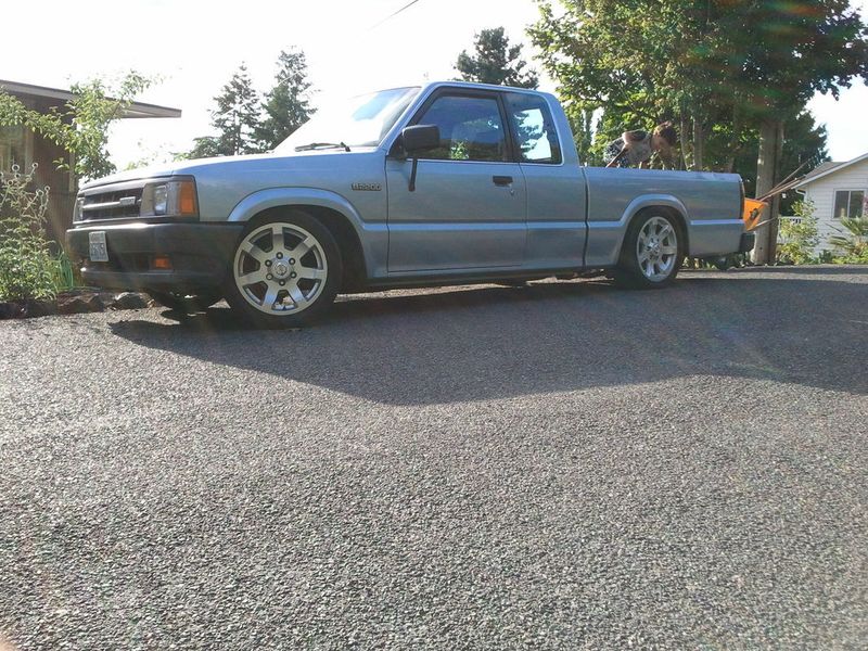

I've seen them on Mazdas before should fit good!

You will have to grind the tabs off of the discs in the front and drums in the rear. The 17s will fit no prob and with the 18s you will need to invest in some 35 series rubber.
If you plan on bagging your truck your truck will have to run 4x4 fenders and bed, have rear wheels machined down a tad or maybe use a Chevy wheel.
