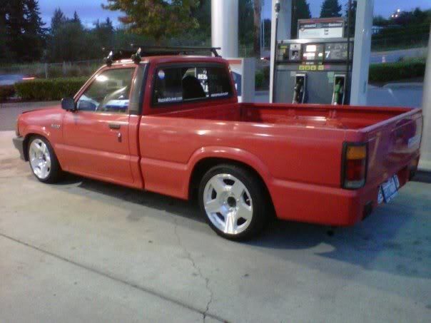

i just got tires on my factory 17's off a 2006 chevy truck and ground my hubs.....just wondering what people are running for lug nuts.....if i need to change the taper that sits agains the wheel or anything?? thanks!!

id def go with the tapered type

Chevy went to the 14x1.5 studs when they changed body styles in '88. The Mazda's run 12x1.5 studs.
Two options: 1. Run stock lug nuts with a conical washer but these are hard to find and i don't recommend it (even though I have done it myself with no problems). 2. Run the tapered lug nuts, the bigger the base of the nut the better. Just make sure the lugs have enough surface area where it meets the wheel to ENSURE it won't pull through.
