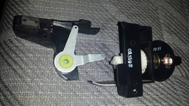

I've seen the temp control adjustment switch break behind the dash. This not allowing the cable to do is job down below by drivers right foot.
