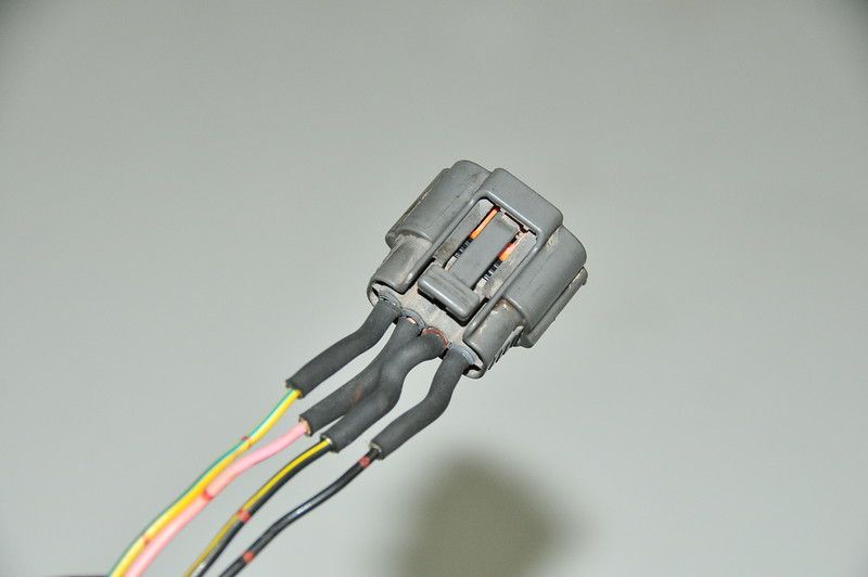

Could someone upload a picture of the plug for the distributor plug on a b2600i, my wiring was loose and caught the fan and ripped all the plugs out of the connector and now im not sure which order they go in. I have multiple diagrams and all of them seem to be a different order. So id like to verify the correct order before i put the plug back together.
scotch
Here you go.....

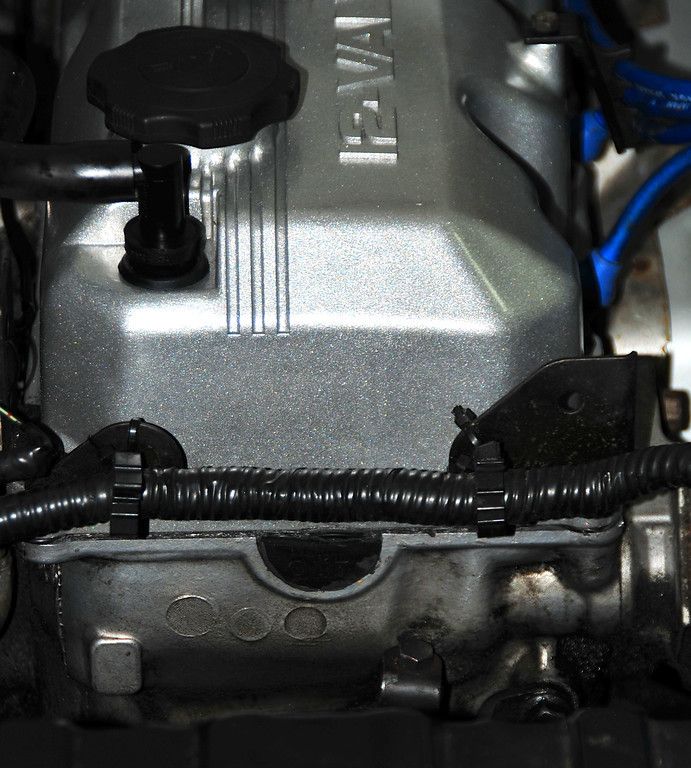

You should have some brackets on the corner of the valve cover to secure that harness. I'm guessing the plastic clips have broken.
