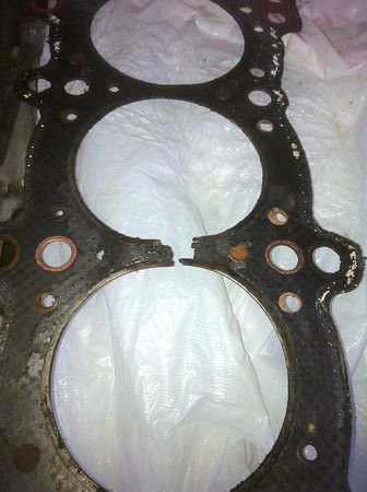

Compression is 150/0/0/150
2114 views
15 replies
stink
Head gasket? Any other thoughts?
scotch
Most likely... blown between the two. Unlikely you had severe valve or ring issues on both cylinders. I have one in the driveway now with a blow-out between 2 and 3.

Thanks again, exact same fail with the gasket. I've cleaned everything up and am read to put it back together. Any chance you know the part number for the gasket for the cover of the timing chain tensioner? I believe that is what it is (the place where you lock the tensioner in place.
cheers, Sean
