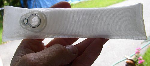

and whats the fuel intake sock ? is that the flat filter chingadera that attaches 2 the fuel pump? & if so do u know where i could buy 1?

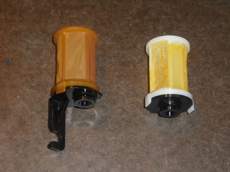

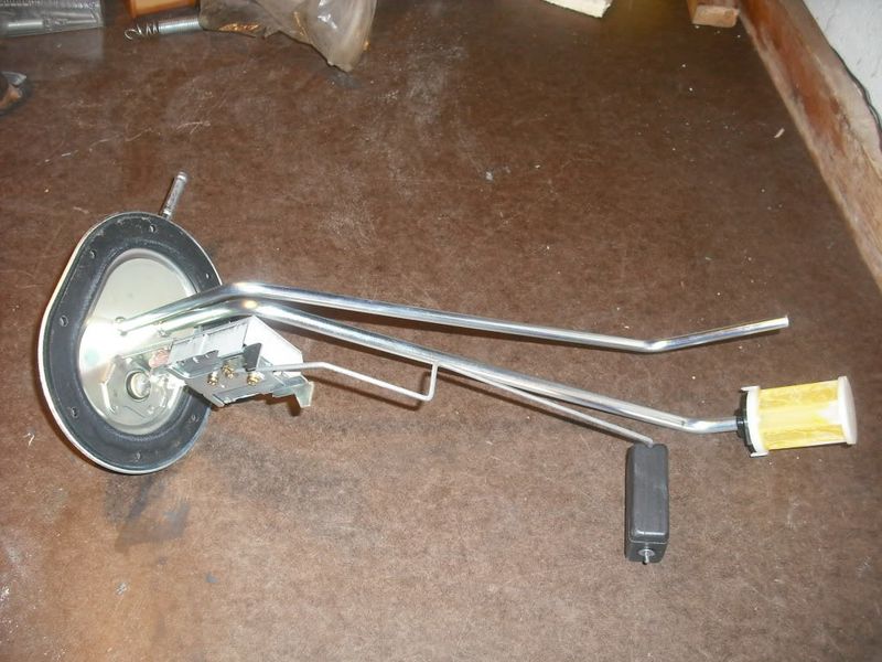

New fuel sock on the right, from Dan Atkins (sponsor here, " target="_blank), as the stock one wouldn't stay on any longer, and was resting at the bottom of my tank.
New fuel sock on new B2200 sending unit from Dan Atkins

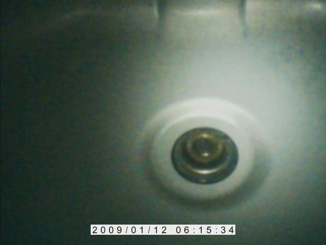

Photo of inside of my fuel tank, using special inspection camera, a gift from daughter. Photo shows no rust or debris!!! Guess that's how I survived for many years without an attached fuel sock.

There are many different styles. The one Cusser shows is for the carbureted engine. Most EFI socks look similar to these.
Any parts house should be able to supply one.
