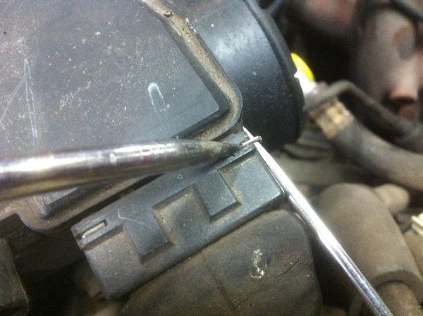

To get the MAF unplugged, you need to remove the little retaining clip. A couple of small flat-head screwdrivers do the trick.

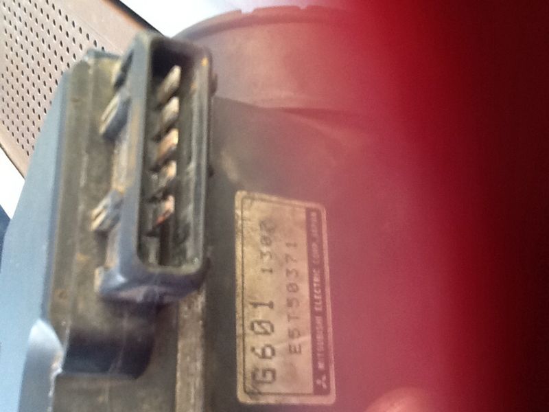

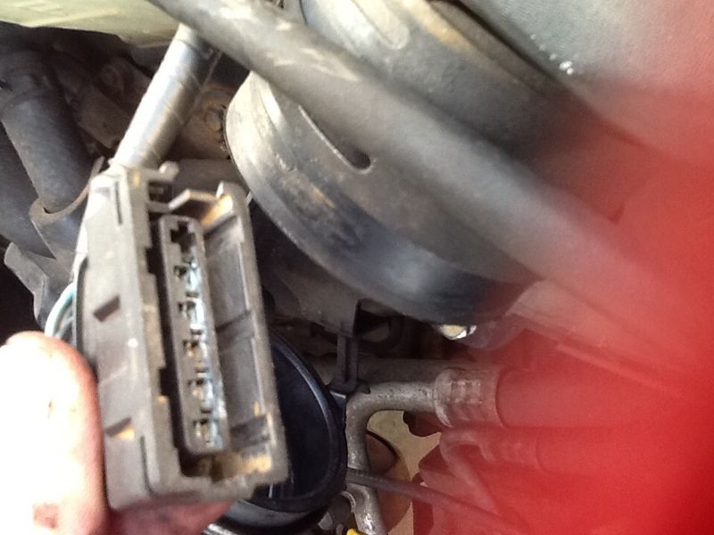

First I disconnected the maf sensor to clean it and noticed that one of the sticks in the plug is missing, shown in pics. Idk if it's supposed to be like that but I doubt it. It also seems a little corroded.

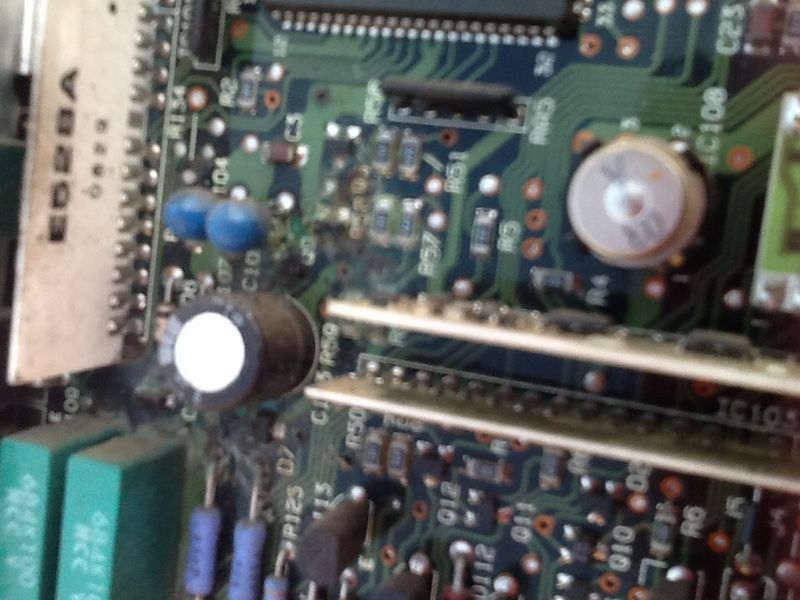

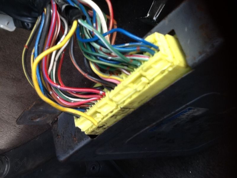

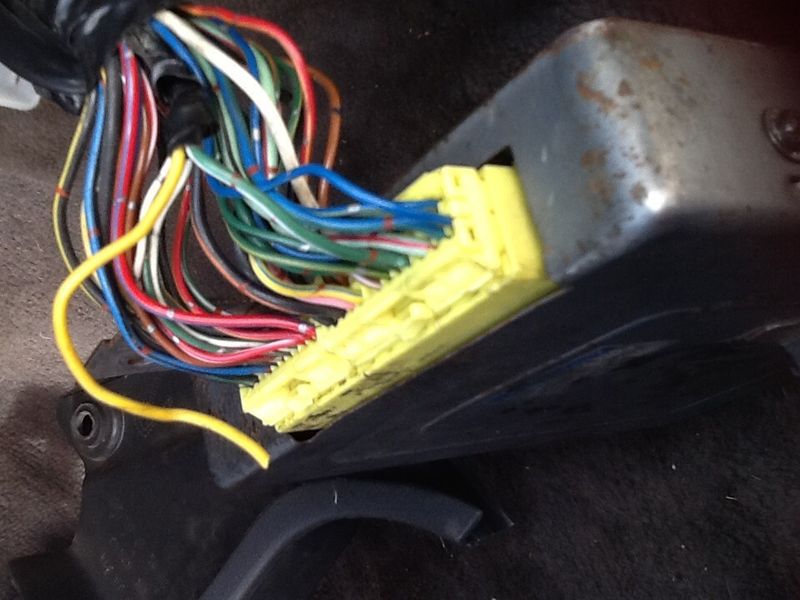

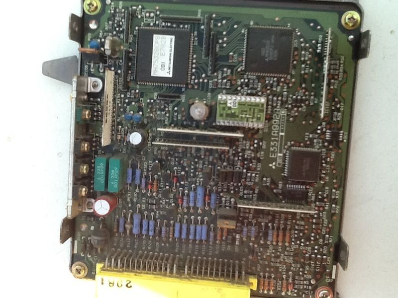

Now for the ecu I took a couple of pics of the yellow wire I mentioned before. I also inspected around the capacitors and you can see a bit of dried up brown stuff. Pics below. Let me know what you guys think.

You're not missing a terminal on the MAF. There is not one in that spot on the left. Notice there is no terminal in the corresponding spot on the harness connecter? Just needs come cleaning of the corrosion... on both the MAF and the harness connecter.
The yellow wire goes to the test connecter that plugs into a Mazda factory diagnostic box. I'm not sure if it would cause a problem or not. My guess is not (unless you were using the box.)
You've got a leaker in your computer. Very typical. That is almost certainly the root of your problems.
