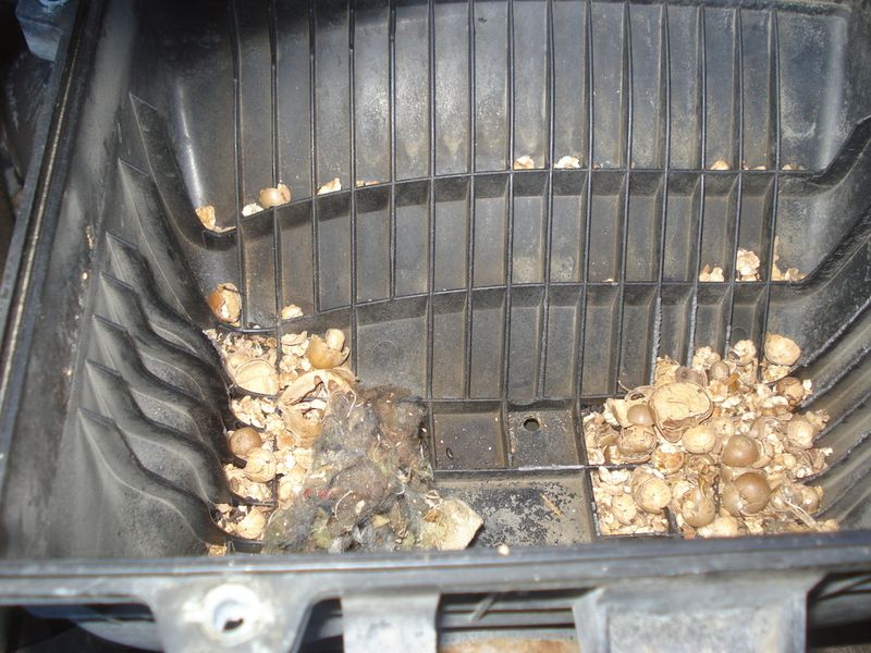

I checked the air filter today and changed it. The filter looked pretty full, and it seems there was a mouse hanging out in the air box, he left a bunch of acorns and fluff. I wonder if all that contributed to the problem. I have to test it some more in the daytime, but it didn't stall while test driving around the property a little, and I et it idle for a while and it didn't die.

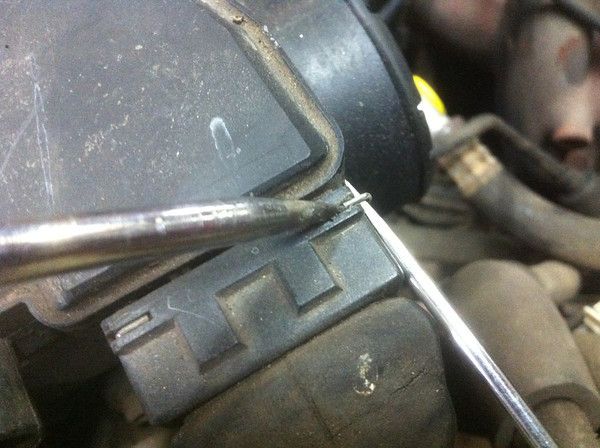

I was trying to undo the electrical connector to the MAF, but couldn't figure out how to do it. I didn't want to damage it by forcing it. How do I get it apart?
scotch
You need to remove this clip to unplug the MAF connecter.
