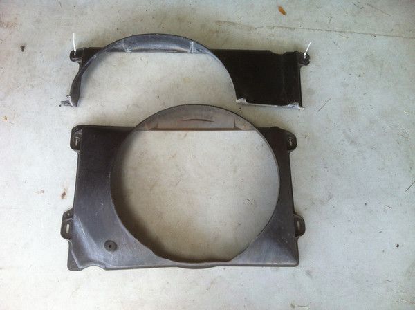

The 2600 radiator is larger and it mounts differently. Also the 2600 fan and shroud are larger.

They are not even close. The B2600i shroud is wider and the fan opening if offset all the way to the left side of the shroud as you can see on the upper half of a B2600i shroud on the top and a B2000/B2200 shroud on the bottom of this picture.
