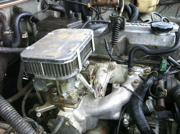

What you need is one of these.....
The B2600i, "de-i'd."
No, I didn't build this one and no, it's not for sale. Well, everything has a price. But this one is not for sale for a realistic price.

@Scotch
That's exactly what I'm looking into changing over. I wouldn't have to pay a mechanic, my father and I do a little backyard repairs. The question I have is what kind of intake do you have on there.

scotch
That intake was on the truck when I bought it. It was fabricated at some point by one of the previous owners - not the guy I bought it from - so I have no way to get in touch with him. You can see the solder joints on the flange and tell that it was was not a production manifold.
To my knowledge, the G6 engine was never produced with a carb, so I don't think you are going to find a bolt on manifold.
