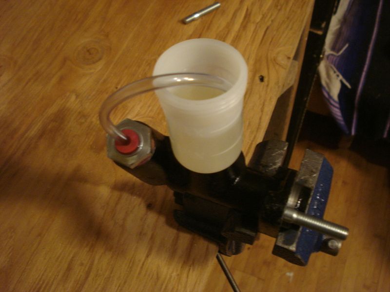

I put the mc in a vise, filled the reservoir and connected a tube from the exit hole to the reservoir.
Where is the plunger? Is it in there and needs to be pulled out somehow?
I've also got to get a better connection for the tube. I just got done with biking to town and back to the auto parts store for wrenches, and didn't want to do it again to get a bleeder kit. I drilled a hole in the grommet that came with the mc and stuck some aquarium tubing in it, but it looks like fluid is already oozing from under the grommet.
Cusser's avatar
Cusser
That looks pretty good. Use a #2 Phillips screwdriver as the "push rod" in the recess of the MC plunger, and press the plunger of the clutch master cylinder slowly in. You should see air bubbles in the plastic bleed tube. Now, when you release that screwdriver, fluid should be sucked back in through the tube instead of air. Keep doing this a few times until it's all or mostly fluid being pumped out and sucked back in. That's bench-bleeding.
