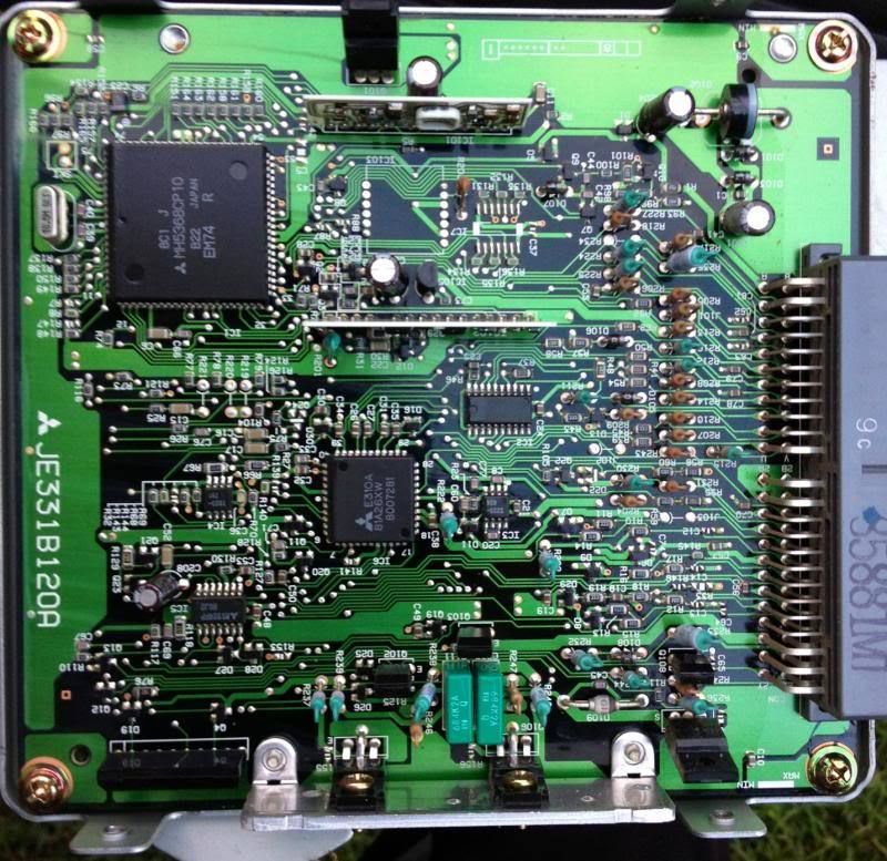

Might pull the cover off the Engine ECU and see if there is any water damage or corosion.
Whats the best way to repair the ECU new capacitors and resolder or new board?
scotch
Since we don't have the duel fuel set up here, I don't think any of us are going to be familiar with how the computer(s) work with the dual system. If the board isn't damaged too bad, it can be repaired. I would think you have some shops down under that can do it. But sometimes the corrosion is so bad the the circuits and the components are compromised and they can't be repaired. You first step will be to pull the cover off the computer and take a look for yourself. Post some pictures. If you see anything on the board around those two caps, then they are leaking and most certainly contributing to your problem if it's not the total cause of the problem.

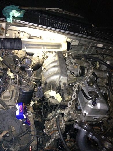

1madgerman
This is a shot of the engine ill get a better one tonight.

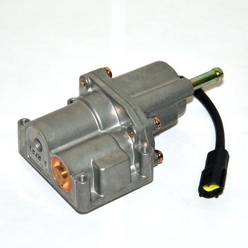

scotch

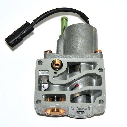

Cool, looks like the same G6 we have then. The here is what he IAC is.
Just follow the harness and unplug it and see if it makes any difference.
1madgerman
Sweet thanks for that, i think it dies when i disconnect it, I think that is the one I disconnected. So I take the side off that has the plug on it to clean the carbon build up?
