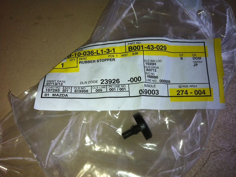

Another thing to look at is the bumper stop pad on the pedal. They can slowly wear a depression in the middle where it contacts the switch. You might be able to adjust the switch but if that depression is deep enough, you'll need to replace it or rig something over it.
Here is the stop pad:

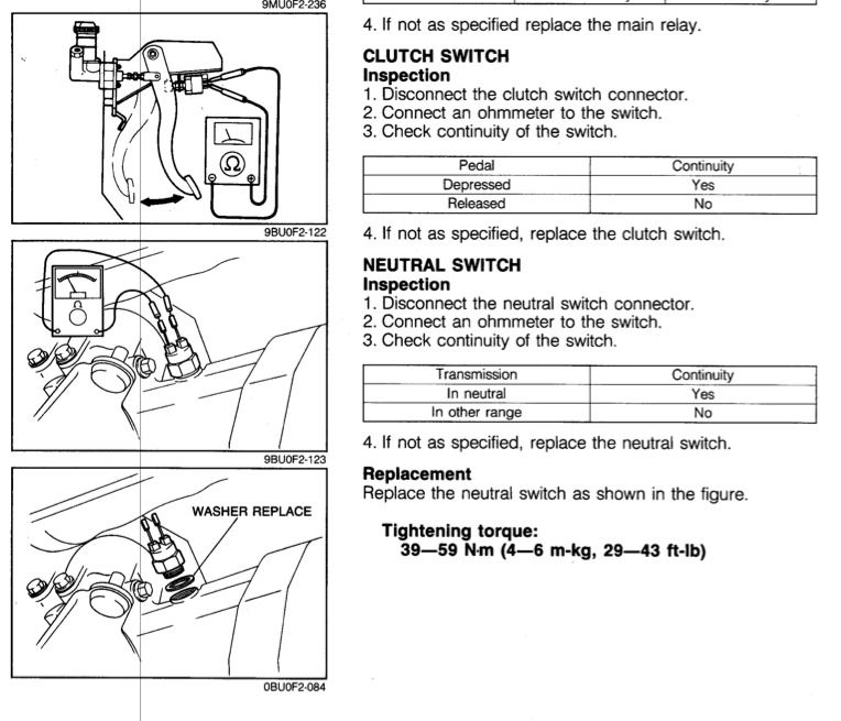

Here is the procedure to test both the neutral switch and the clutch switch. On the clutch switch, you'll probably need to have a couple of leads with female spade connecters in order to check for continuity with it installed. You can always take it out and test it, but if you have that depression worn in the stop pad, then it might test OK on your bench but not be opening the contacts when installed. If you see a depression there, you might tape a penny over it for testing purposes and see if the switch is opening when the clutch is released.

Also, you have another one of those stop pads for the "other" clutch switch (start inhibit switch) as well as the brake switch. So you might as well check them all as long as you're looking down there. They run about $3.00 at the dealer.

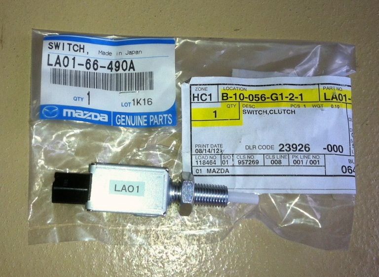

Here is the clutch switch itself (about $17 at the dealer.)
