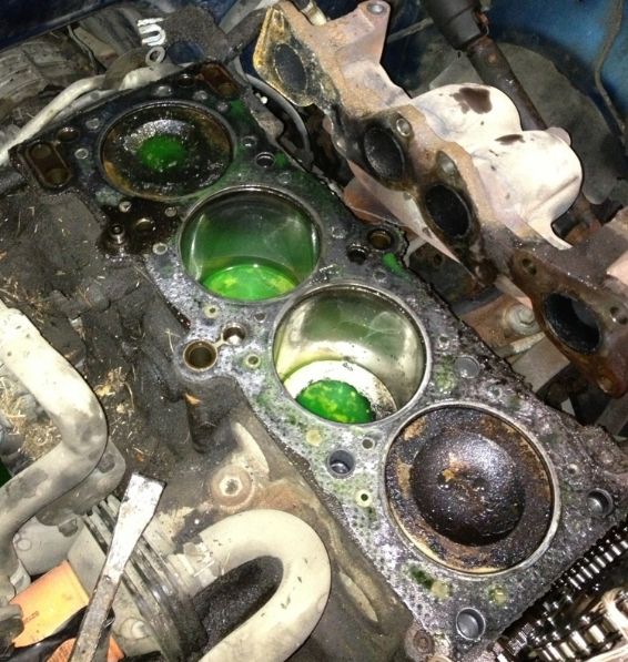

So. . . . the deer took out the radiator, and I put some stop leak in to get it through a day or two until I arranged for another car. Fixed the radiator, but the stop leak took out the head (I think. . . ).
Yesterday the head gasket went out, so now to change the head and fix the noisy valve as well as the head gasket.

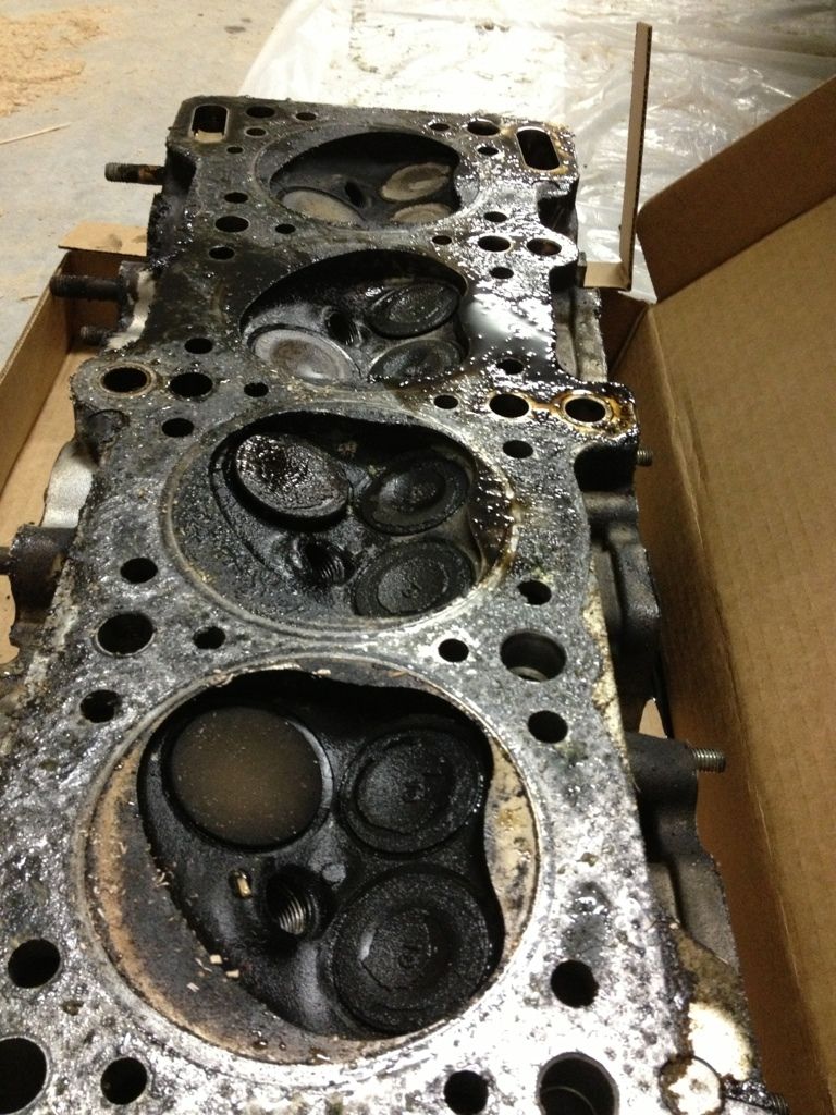

Can you guess which cylinders were eating antifreeze?
And what cylinders had valve issues?
