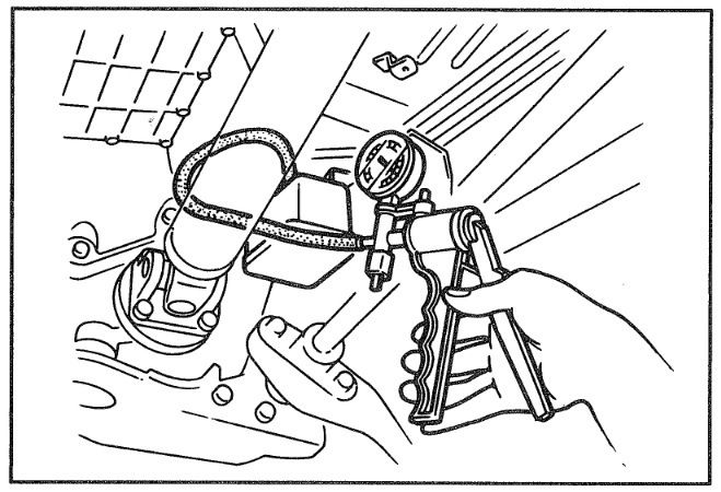

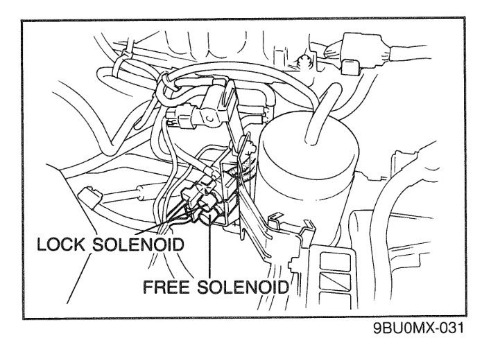

where is the vacuum actuator for the 4x4 auto hubs? just to rule out suspicions...
9
91_2600i
Here you go. These are the main RFW components for the 91 4x4. You will probably have additional solenoids for the fuel pressure regulator and gas tank vent, so you might need to follow the vacuum lines and make sure you have the right solenoid in hand. The Vacuum reservoir is shown for the manual transmission. On the automatic, it sits further aft, near the transfer case.

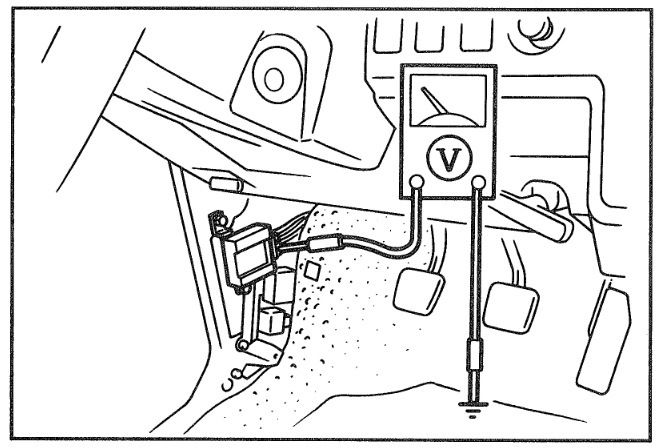

how many volts should I have at the computer? and what tool is it to test pressure?
9
91_2600i
Just PM'd you the test procedures.
