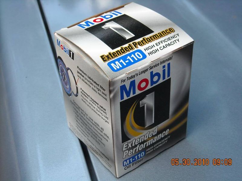

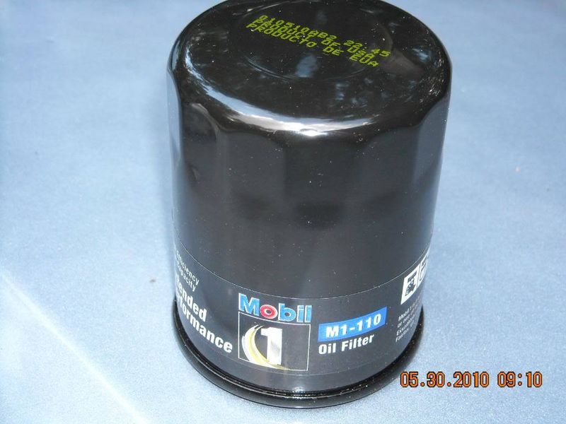

Here is a pic of the Mobil 1 oil filter I am using.....
I think this anti-drain back valve in the filter is the reason it helps keep the oil in the valvetrain overnight....actually, over the week!
