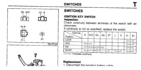

Yeah, in general, you'll want a "normally open" pushbutton switch or spring toggle switch to actuate the starter. However, see this ignition switch diagram.
When you turn the key to "start", it also shuts off momentarily voltage to the accessories such as air conditioner, radio, etc. and the IG2 circuit. It also connects the L and E circuits together.
