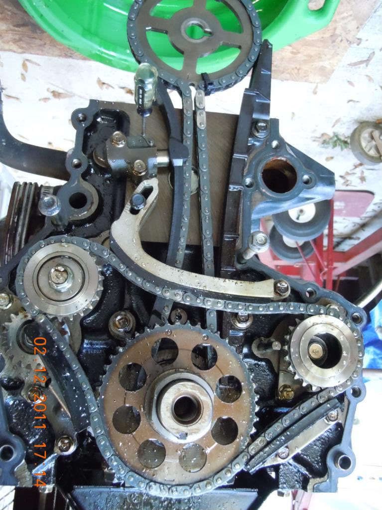

I would change both, plus you will have a balance shaft chain and 3 gears for it as well.

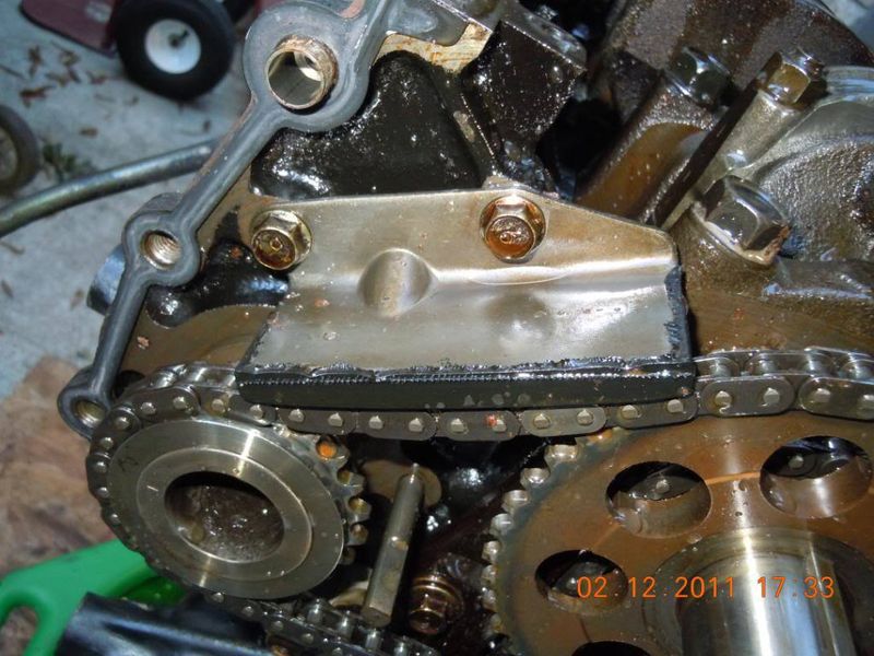

The guides I have seen and used in my 1991 B2600i trucks have ALL been steel backed.......steel cored really, they look like they're plastic but they have a core of steel. Two of them.......left & right.
The balance shaft guides are steel backed as well.......three of those....left, right, & upper.

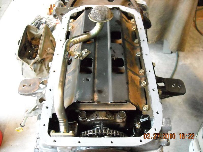

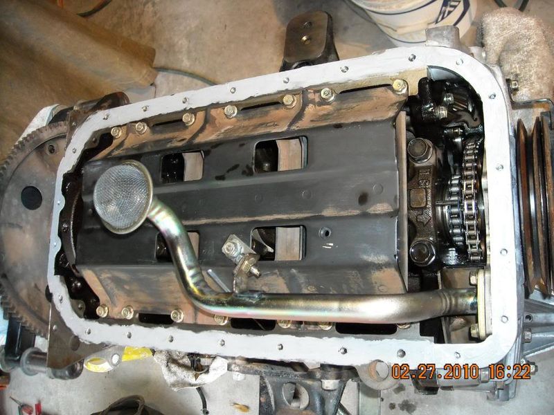

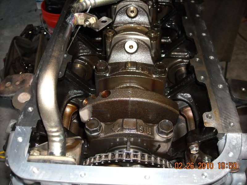

The worst part of it is that you HAVE to drop the oil pan in order to get the timing cover off. The oil pump IS the front timing cover and the oil pick-up tube is bolted to the oil pump, naturally, so even with all the front cover bolts removed, you still can't get the front cover off.
You can do this with the engine installed though (in a US market 1989-1993 Mazda truck) you just have to lower the steering drag link to allow the oil pan to lower enough for removal on a 2WD truck......not sure what is involved on the 4WD truck to do this.
Here's a few pics of the bottom end and front cover.
