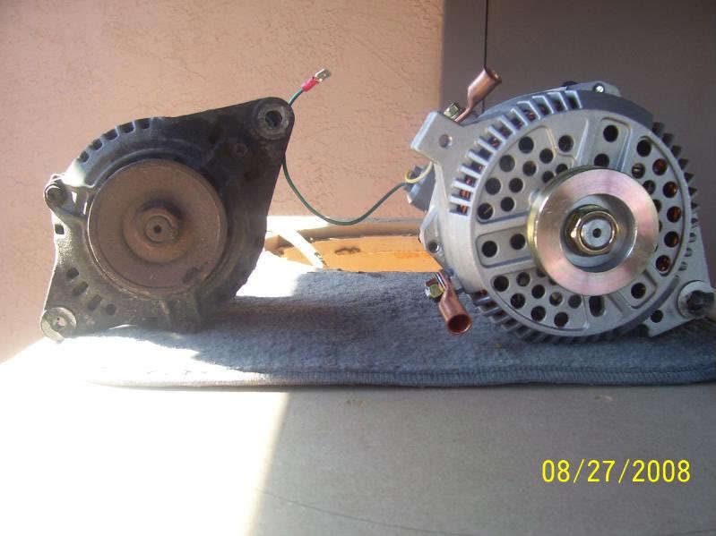

well you can always get an alt like mine
well this is my old one...250 amps. my new one is 280 amps

yeah i plan on doing the wire upgrade. reason i asked about the gm 1 wire is i seen topics of people flipping em upside down and they bolt right up but didnt know if they worked on the braketry of the 2.6 fi motor. hunter where did you get ur alt. and about how much and is it direct bolt on. as far as budget, i dont mind spending the extra on getting the better product that i will get the best performance and longevity out of down the road

I got that alt from mechman alternators...it cost me about 450 its def not cheap.and it took me a little shaving down on the bracket some but it wasn't bad. And if you call them they can make one for the 2600. I think the gm 1 wire might be a great budget alty that will do great.
