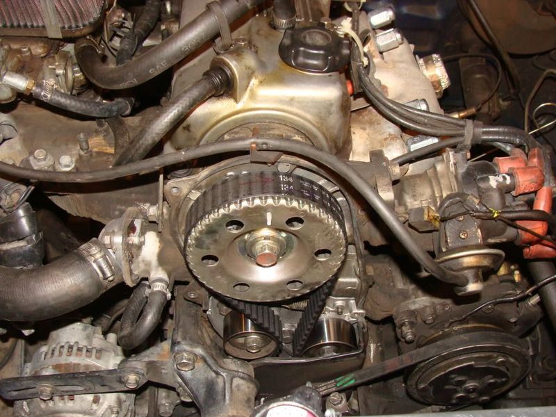

Cusser's avatar
Cusser
I used 14mm x 1.5mm wheel lugs from O'Reillys ($4.99 for four) to plug the pair tube outlets coming out the upper manifold heat shield.
I had photos of all this, but the post was apparently lost in the crash at the old site of Mazdatrucking.com.
This may help some
