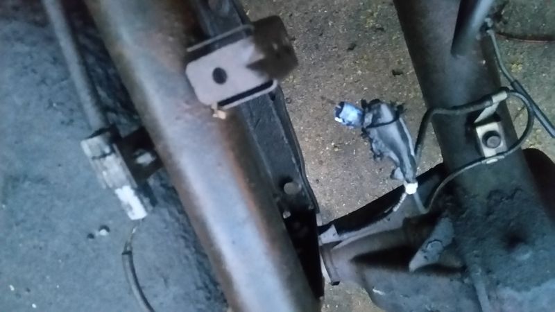

Morning everyone,

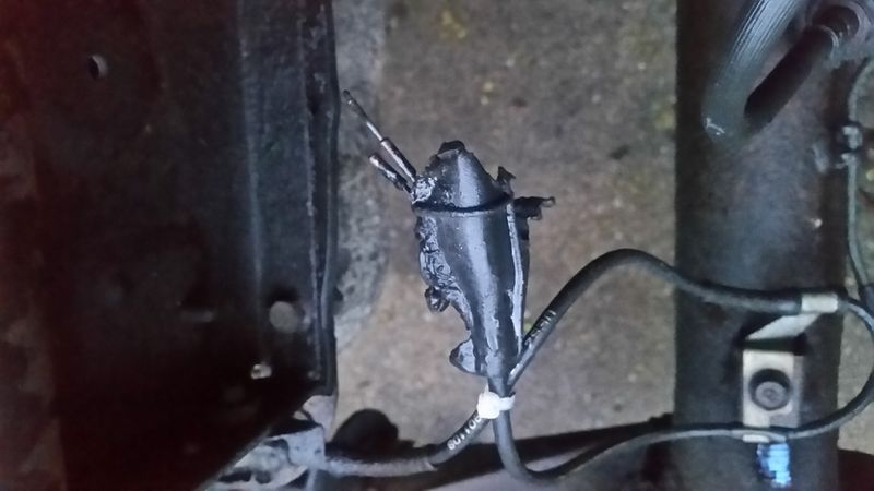

can anybody tell me what this wire connection behind my fiel tank is for, it burned up and it looks factory?

Anti-lock differential sensor wire.

Thanks, that must be why the light is on.
it looks like ill need the whole thing replaced. Rock auto has it for 160.00 but i dont think the cellenoid is included. Any suggestions for getting one cheaper?

Junk yard. You can probably get the sensor and the pigtail for less than ten bucks.

I only use my truck in good weather so i dont really need the abs however i dont want the light to stay on. Is there a way to disable the light?

Pull the abs fuse.

If you need to find what else may use that sensor, find the part on Rock auto, and click on the part number, it shows all vehicles and years that use that part. But a sensor like that is probably only used on the B2200 and B2600.
