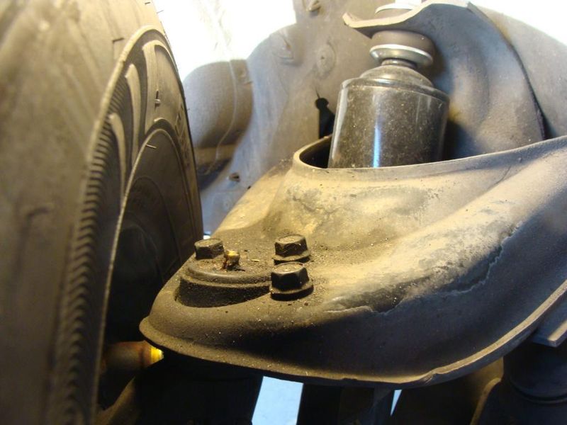

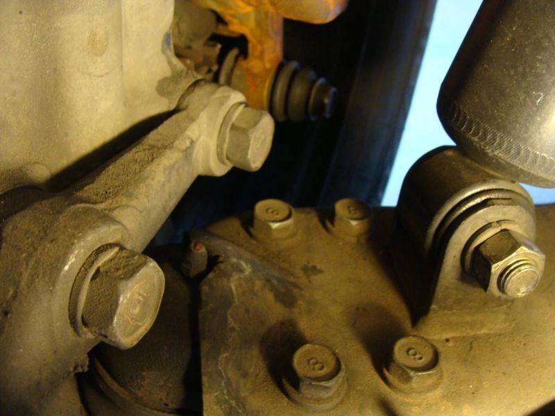

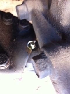

On my '88 B2200, to fix a squeak I removed the four UCA threaded plugs and threaded in four 6mm grease fittings (three needed to be 90 degree-angled fittings). Then I greased them up from my grease gun with flexible extension, and grease them every few years.
I also have had front end squeaks unrelated to this on both sides. A mechanic diagnosed/fixed a bad ball joint on my driver side to fix. Then a decade later I had a squeak on the passenger side, so I installed two new ball joints from Autozone on the passenger side. Those came with grease fittings, and I ised them. The upper ball joint fitting faces straght up, and for the bottom fitting I had to cut out a little notch for it to fit.
Really? Can you post a photo? I just had my B2200 up on jack stands Saturday (to check the brake pad thickness), and clearly remember no issue with the upper ball joint grease fitting, very accessible. So you're saying that even with front end jacked up you cannot access this? I think we need good photos posted here.

As Cusser said, post a picture of your setup.

Take a photo from the front and back at the ball joint level.
