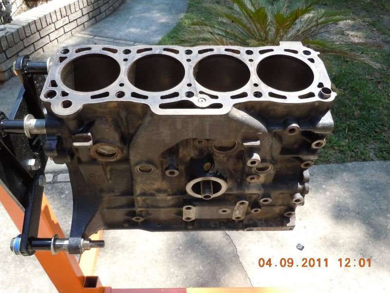

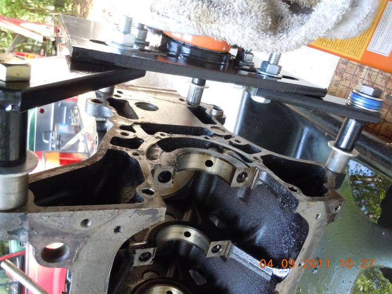

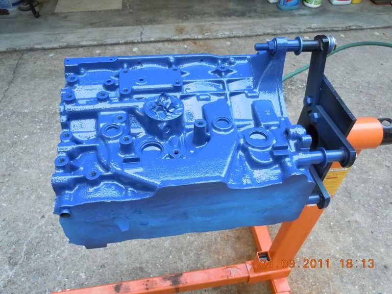

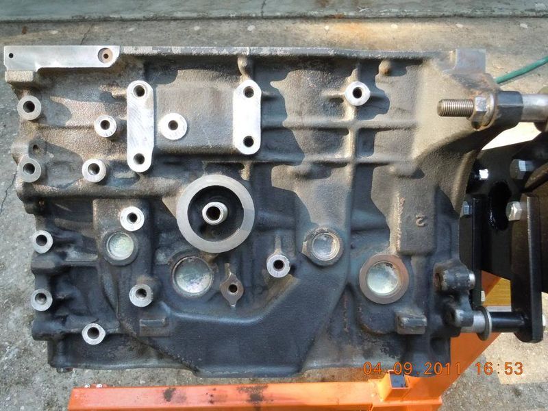

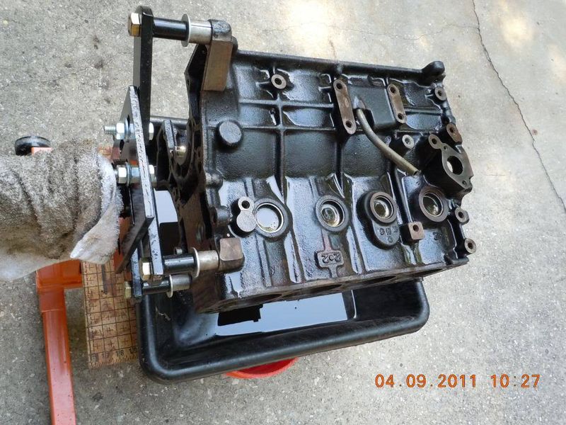

Here are a few pics of how I do mine......I use the large metric bolts like the stock bolts, and washers & spacers to get it all spaced evenly.......plus, this gives me room to go ahead and install the flywheel while it's on the stand if I choose to.
As you can see, some of the bolts I have are longer, so I just stack some 1/2" washers behind the bolt head to effectively shorten that particular bolt.
