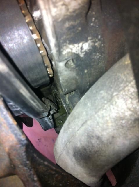

I was able to pry the lower timing belt cover a bit today. I found two holes on the drivers side. It looks like my coolant is coming out the lower hole. Do these look like the water pump weeping holes?
87forever's avatar
87forever
I would say the wp based on the pic.However you have coolant hardline tube that feeds into the back of the waterpump area which has a (oring) rubber and can leak as well.In short the hardline pipe feeds to the heater core and if the pipe corrode's enough it can leak down the front side around the wp.If your wp has never been replaced I would replace it and suggest using permatex's The right stuff gasket sealer as this set's up quick and cure's fast!This product is not cheap and come's in a cheese wiz style can for about 13.00 for the small unit sold auto zone,advance etc.This product seals just about any fluid type and I have yet to find a fault in this based on my use!If I am not mistaken the waterpump kit comes with a NEW oring for that hardline pipe in the kit from at least auto zone as I bought my wp from them.I have seen pics where the hardline pipe has corroded so bad the pipe had to be replaced from leaking coolant and while the oring was toast the pipe itself was done due to corrosion.Too much info cannot hurt.1 last thing use some atf or white lithium grease or even wheel bearing grease on the oring for the hardline pipe prior to install.
