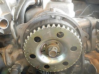

I've attached a picture of the camshaft sprocket with the crank at TDC. Sorry for the quality, hopefully, it's clear enough to see details.

As long as the dowel is in the alignment hole in the cam gear you should be okay.
Did you check the crank position timing? That has to be set to TDC (top dead center) on the proper stroke - the crank must be turned twice. Also the distributor has to be set properly after the timing is set.
The timing should be set withOUT the vacuum line attached.
Also be sure to align the two marks on the distributor (hole and mark) are aligned when you insert it.

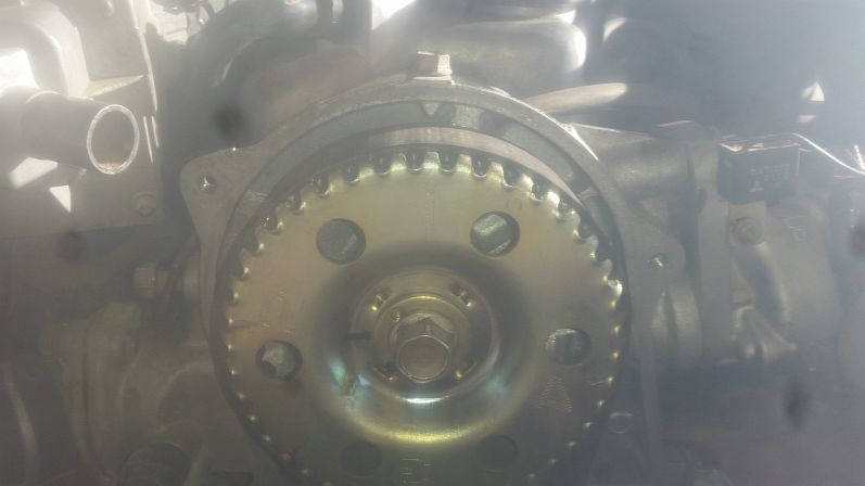

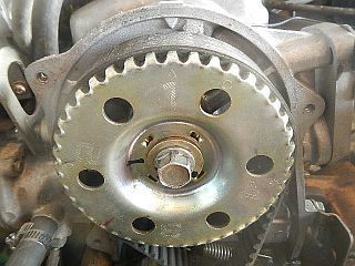

The dwell appears to be stuck at 0*. I'm beginning to think that even though the camshaft marks are aligned, it's not correct. I think there's no vacuum in the manifold so the computer thinks the vehicle is under acceleration and dumping fuel into the carburetor. I'll try to get some better quality pics of the camshaft sprocket and crankshaft pulley.

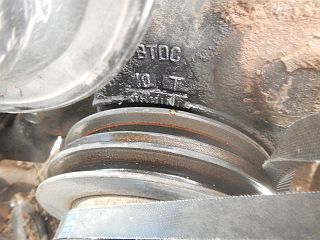

So I guess the question becomes, how do I know where to set the camshaft if the timing marks are incorrect? At TDC, are both HLAs supposed to be on the base circle? The intake valve just closing, and by how much? If I have no vacuum, is the cam retarded or advanced?

I can not tell from the picture, do you have both the crank and the cam marks straight up, aligned with the marks, not ninety degree toward the driver's side? That is what this manual is showing, straight up, have pointers there to align with.
