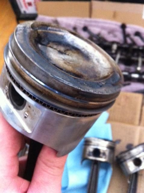

Well, I just got the pistons out. Most of them are pretty good looking. None of the rings were stuck. However, two pistons have a bit of a lip around a portion of the top. The lip is about 3" of the circumference. I'm assuming it's from them bashing into the metal portion of the head gasket that was mangled. I've attached a photo of the worst one. I've also attached a photo of the head. You can still see the cross hatch marks on all but the number 2 cylinder. This piston also had some coolant on it when I removed it. It was the piston with the worst lip.
Do you think I can sand off the lip and reuse them? Should I replace the 2 or do I need to replace all 4? I should probably still at the least replace all the rings, right?

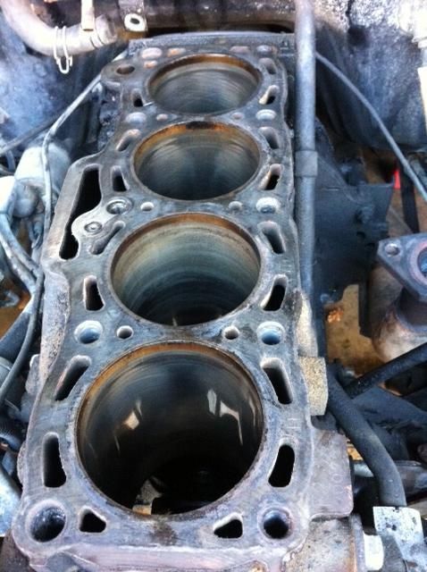

I believe that the pitting issue I have with the block deck is not pitting. I think it was caused by the messed up head gasket. It is all in the same place where the gasket was bent. The deck is otherwise flat. I cannot get a .0015" feeler gauge under it anywhere. I know most of you won't like this, but I am going to sand down the deck with a piece of flat cast iron and see if I can take out the defects. I will plug all oil and coolant passageways.

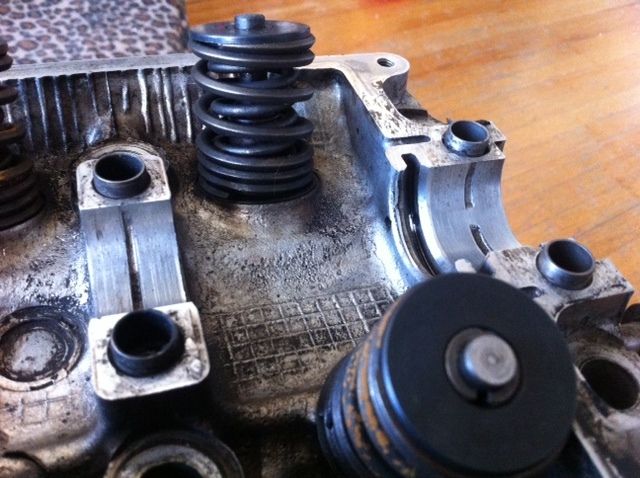

The head is also in fairly good condition. I can barely get a .002" feeler gauge under it anywhere. However, there is something that concerns me here too. I've attached a photo of where the cam shaft sits. You will see some oil grooves that seem to be worn away. Is this the way the head is manufactured? When I put the cam shaft back in, there is no play whatsoever.

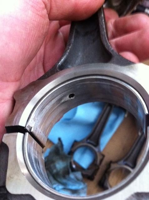

I think I will replace the bearing things where the connecting rod attaches to the crank shaft. They are a little messed up.
