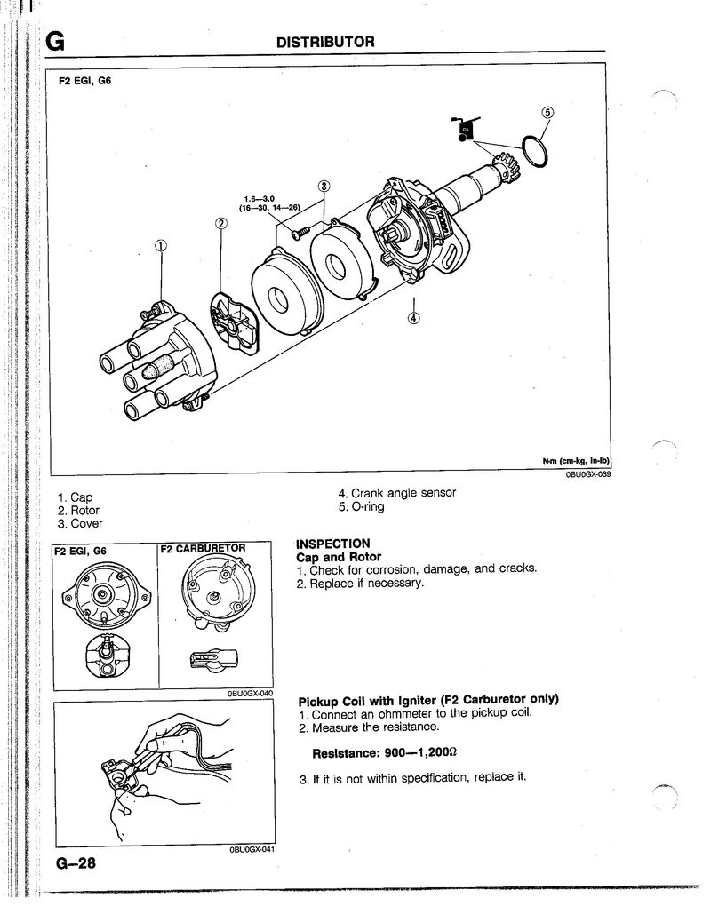

I have no resistance across pickup leads, bad?
sincitylocal's avatar
sincitylocal
It's bad.
Have a look at this.
geterdun's avatar
geterdun
Picture does not open.
sincitylocal
It opens on my PC, but not my phone...
