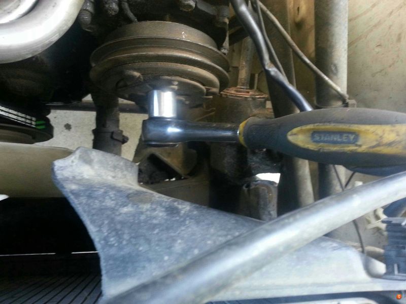

getnpsi's avatar
getnpsi
://img.tapatalk.com/d/14/05/16/gydyzege.
getnpsi's avatar
getnpsi
Tool in the last picture is amazing the ratcheting handle twist in both directions but spins the fastener in only one way that's selected. Yes it spins freely
Cusser's avatar
Cusser
OK, so the compressor is not seized.
