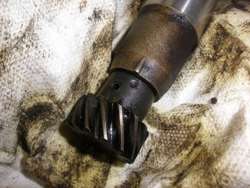

PS. Don't forget to line up the two marks on the distributor shaft when you stab it back in!!!!

See the "dot" and "line"... these should be lend up when you put the distributor in.

ooh. I see now. I didn't even know about that at all. I don't know what I did but today I took the belt off and set the timing from the first step.
I only used my TDC marks for #1 I made on the distributor when I installed it but whatever I did is working. The timing light confirms that Im set correctly and it is steady this time.
last time it was a little jumpy but this time its coming up clear and steady on the crank pulley mark at T when I set my advance on my light to 6.0 and low and behold she is running fairly smooth. its not a perfectly balanced motor but I know im in a good place with the settings because when I sit at a light with the shifter in nuetral it doesn't bounce like it did before it just sits there lightly vibrating.
