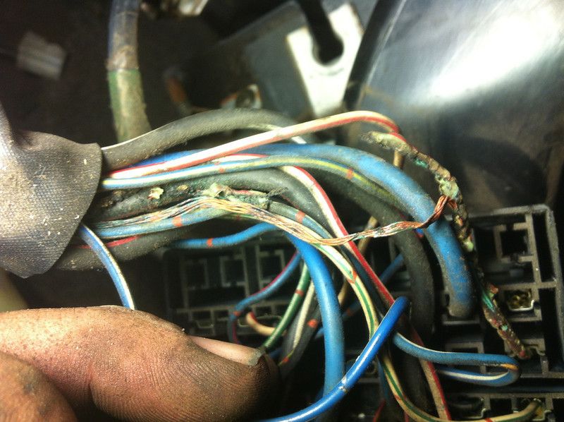

I have a 1988 b2200, manual transmission. Above the drivers side kick panel. There is a plug, about 2" X 2" with a Blue wire w/white stripe & red marks among other wires running to this plug. I don't see it in my manual. This wire is nearly burned up & my truck runs like s#@t. Trying to trace a problem to see if it is my ignition. Timing is all correct & no vacuum leaks. STILL looking for the problem.

mazdatweaker_2
Does the plug / wires look like this?
Cusser's avatar
Cusser
I think those blue wires with the stripes and little brown bands go to the wipers, look at the wire inlet for the wiper motor.
reno88b2200
Not quite that bad tweaker, but I think that is the wire yes
