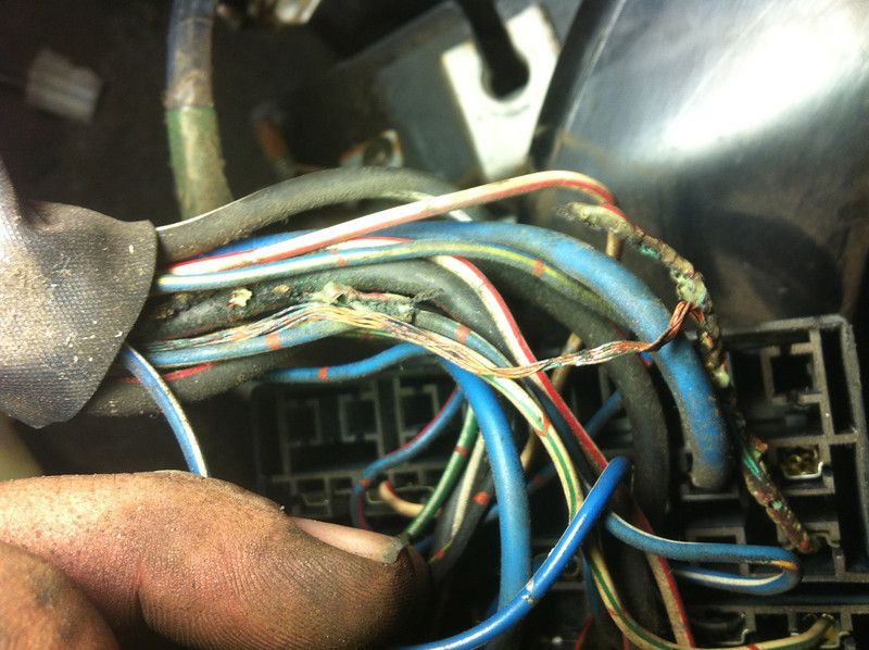

You can look at the ignition switch and it's harness and I would also try to get a look at the back side of the fuse box in the dash to check for chaffed and shorting wires. But, you're probably going to want to pull the dash to really get a good look at all that wiring... unless you find something simple like an amplifier or other power wire poorly routed through the firewall - without a grommet for example.
I've seen several fuse boxes with shorting wires on the back side of it like this one....
If you're feeling brave, you can try it some more and see if you're getting 12v at the coil with the ignition switch in the 'ON' position. If not, then you have a starting point. But it's not going to fix itself and is going to need some repair whatever/wherever it is.

Well no it hasn't smoke since that time, it just cranks over it doesn't even try to start. I've pulled that dash apart and cant find any short or chaffed wires... but I have notices two fuses that pop every time you try to put a fuse in the socket. The two fuses say Engine and Room. I don't know exactly what they control but the big wire on the back is connected to both of these wires. Im going to trace these wires and see if I can find anything but so far I see nothing.
