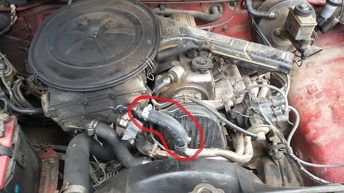

Under the hood I WAS missing a hose that connects from the exhaust pipe to the air cleaner (see pic)
I noticed that when the vehicle is running exhaust fumes pour out of the exhaust side (who knew?) and will leak into the cab filling it with the wonderful smell of exhaust. I went to my local parts store and got a hose to plug it up as you can see in the pic and although now it's not spewing exhaust into the hood/cab while I'm driving it's started running pretty poorly with really no power at all and the check engine light coming on and off every so often. I'm not sure what the source of the problem is as the truck is barely drivable with the tube on, and fairly unpleasant to drive with it off with all the exhaust coming to the cab
Any thoughts on what the problem could be, I thought perhaps the previous owner had plugged the air cleaner side and thats why it was affecting it so poorly but I checked and it was clear straight through
Thanks a million,
Jim
sincitylocal's avatar
sincitylocal
Your catalytic convertors plugged.
anguswilly
I think the valve that controls the exhaust flow is stuck - quick fix would be to plug that hose.
