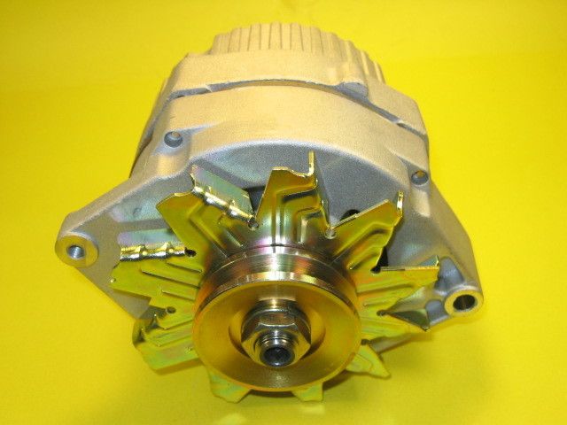

Are there any alternators with higher amps that are a direct fit to our B's? I know some people use windstar alternators or early '00 gm models, just curious what one in particular that i should try and get or would any one i choose require re-wiring and mounting brackets?
spacemonkee23's avatar
spacemonkee23
I just put in a GM 76-83 vehicle year 105amp (ebay) alternator in mine took about a half hour. But mine is 3 wire 1 bigger gauge to the battery and 2 at the connector (EFI). If it is carb'd I think you need a 4 wire 1 bigger gauge wire and 3 at the connector for the choke, batt light and VR.
I just had to drill out a bigger hole and mount it upside down, widen my stock tensioning bracket with a grinder and solder on a new connector that was $2 at the parts store. Oh and I needed a thinner belt... easy. Plus i added a 4 gauge wire from it to the batt. Not sure if it will work for carb'd models though. Maybe you can use the choke off a different circuit?
This alternator was 70 bucks and provides plenty of amps with my HIDs, LED bar, sound system, heater all running. I have a bunch of pics from the install on my camera at home that I can do a write up on maybe this weekend some time if you want...
You could do a GM 1 wire but I like having the idiot light and reference for the Voltage regulator so I don't have to "excite the alternator" like in a 1 wire setup.

Appreciated Cab+Driver, and Spacemonkee, i had seen the 1 wire gm alternators on the advance site, very nice ampage i think up too 120, have look be sure, but not very concerned about the idiot light, the alternator tested good twice, and even after i removed my amp and foglight hookups it still happened and wont start.
Now, my next question is, what is the 1 wire gm alternators exactly? I have never seen or used a 1 wire alternator so kinda something new to me. would it just be connected to the battery terminal? Or would i have to mock up a ground to it?
( EDIT ) just re-read your post Spacemokee, when i removed mine i had only 3 wires, one with a nut holding the power wire on, and two connectors, one to my choke and the other the dummy light i assume? and excite the alternator? As well I don't have a voltage meter just the dummy light.

The three wire setup was simple with mine... I have EFI so it may be different for you. The wire w/nut goes to the battery + (I used 4gauge Amp wire - extra from my sound system) and the other two at the connector are 12V constant and 12V ignition. Its was as simple as that for me, Just a little bit of drilling and grinding to mount it up plus a little soldering. I'll try to post some pics this weekend.
1 wire alternators use a different charging method. With the 12v constant and 12v ignition plugged into a 3 wire, the alternator uses those signals to know when to start charging and when you turn on the ignition. With 1 wire setups there is no reference voltage to tell it to start charging other than it is spinning, so when it reaches a certain RPM it recognizes or "excites" the alternator it and charging begins. I think with the higher the amperage the higher the "excite" RPM is... Or at least that is my understanding of it... I'm sure someone on here can explain it better (or correct me).
