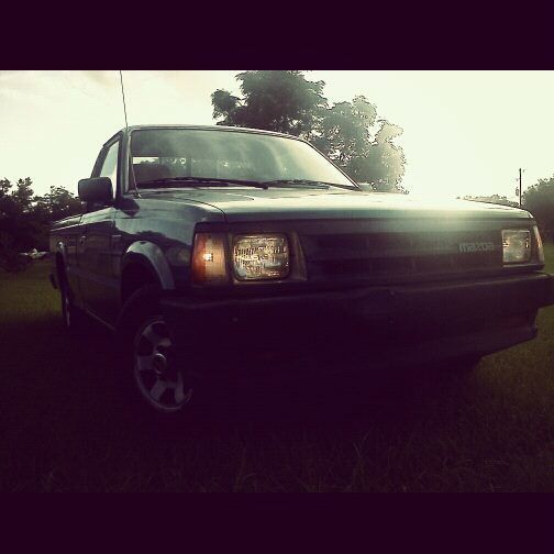

Hi everyone, I'm new to the B Scene and to this forum(although I may have made an account a while ago, but I forgot the info), but I have a problem and I'm hoping you guys can help me out. Generally speaking, my clutch works great! But once in a while, the pedal starts getting soft, and then a few minutes later it gives out completely, and I can't get it into any gear unless I turn the truck off. I've had the problem once or twice before, but we replaced one of the cylinders(I can't remember if it was the master cylinder or the slave cylinder) and it seemed to fix the problem. But this happened to me a couple days ago, and I got stuck at a small intersection. Fortunately I had read about driving without the clutch and was able to learn how to do it well enough to make it home. I felt like the best driver in the world Lol What's funny is that it works just fine again o.O But anyways, in all seriousness, can any of you help? Thanks! Here's a picture of my baby, a 1992 Mazda B2200.
