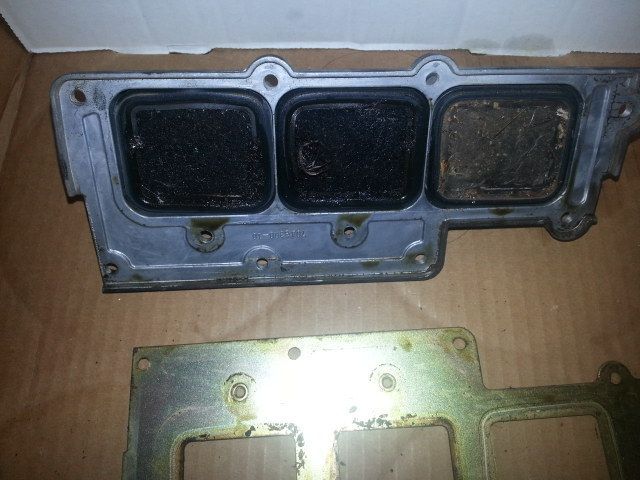

I cleaned the egr, reed and air filter housing/assembly entirely with two cans of catalytic converter sage choke cleaner ($6 each can). Everything was taken off and cleaned- hoses, screws, clamps...

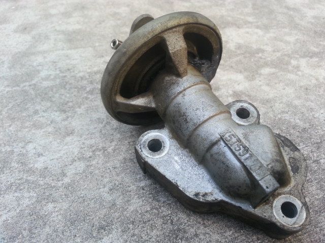

The EGR had to be carefully chisled with a small screw driver after soaking in choke cleaner carefully not to expose too much of it on the EGR "diaphram" (to be safe not knowing if it potentially would harm it). The carbon was so hard like charcoal briquettes- literally. Yes, the EGR worked prior to the cleaning.

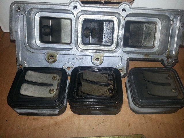

The reed valve assembly was unusual. All rubber seals were in good condition- before and after. There are three square chambers each having one square cartriage containing the reed and sponge-like filter. The reed, cartriage and reed "curved" support were in good condition. Now the filters. All had carbon and dirt. One had a little of oil with excess collected within the chamber along with small size bee's and other like insects. The second was dry and o.k. for a 20 year old truck (I guess). The third had some feathers. What a transition of conditions, LOL. The three EGR filters along with the small "fig newton" air breather filter that's in the air fitler housing were soaked in choke cleaner rinsed with water (why?) and left to air dry till the next day.
