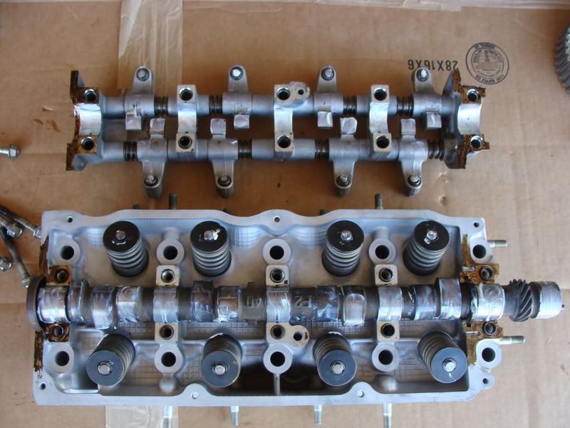

The rear seal behind the camshaft is shown in this photo:
Other photos might help, see

Do u have a pic of the back of the camshaft installed on the head with the rockers installed?
