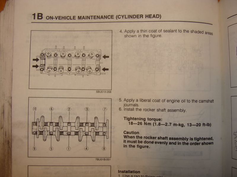

ok so no sealer even in the camshaft caps on the corners?? i should be good?
Cusser's avatar
Cusser
Are you thinking of this?
For the valve cover gasket itself, I'd say either no sealer or possibly a THIN coat of Permatex Aviation. If I remember, I used Permatex Aviation in the places shown by the arrows in the photo.
I've seen Permatex Aviation at Ace and at O'Reillys, and it is removed by alcohol.

yeah thats what i was talking about thanks i had to order the fel-pro gasket thanks hopefully it fixes it cant stand oil on the outside of a brand new motor
