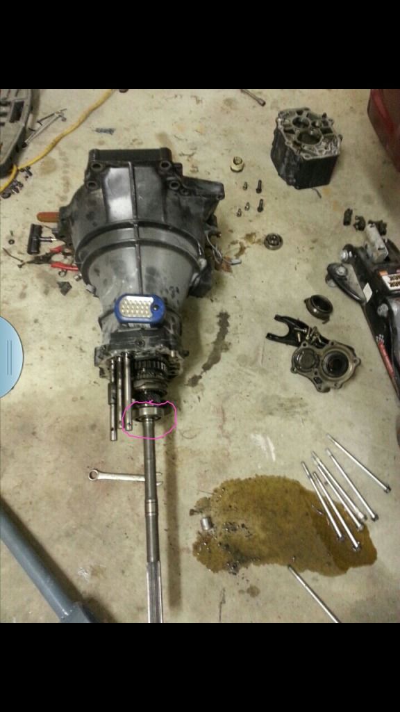

Well still no luck gettin it out of reverse . So im pulling the tranny today. I think my rear main is leaking anyways so I figured I gotta find this oil leak anyways...lmao. once I get the tranny down what am I looking for to get this to release? Or do yall think the tranny is messed up.
