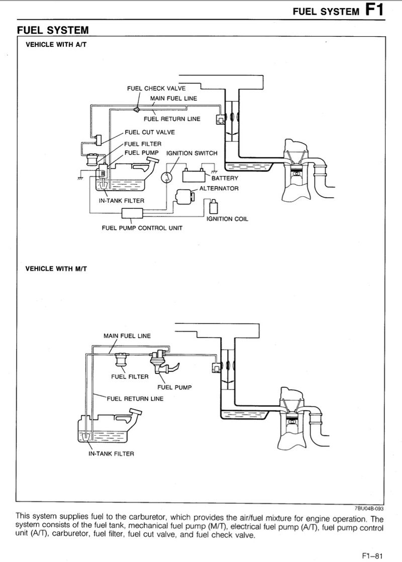

Here are a few pages & specs of the fuel system (1989 B2200), FYI:
