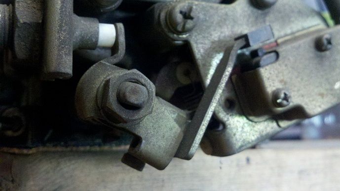

I am having troubles on my '91 B2200 when accelerating. It is mainly at low speeds and smooths out as you get going. I have already taken the carburetor apart and checked the accelerator pump and looked for anything else that could be malfunctioning. The only thing I did notice was there is a switch that is pressed when "turning" the throttle. The button on the switch that I am talking about only gets fully pressed and "clicks" when at wide open throttle. I hooked up the ohm-meter to the sensor and it only reacts when the switch is fully pressed. It's like the spring mechanism that turns it has lost its strength. Or is it supposed to work like this?
The part I am talking about is 24-310B in the diagram and I guess is part #FE0113XH0 which I can find no information about. Help would be great, thanks.

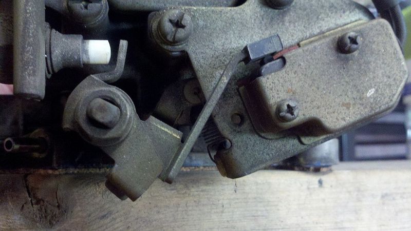

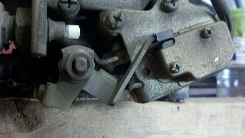

This mechanism doesn't seem to be affected by vacuum. Now that I am home here are a few pics of what I'm dealing with and wondering about. Any input is appreciated. I am mainly concerned with the lever pushing down on the little black "button" on the right side of each photo. The white diaphragm seems to be functioning properly from what I can tell.
