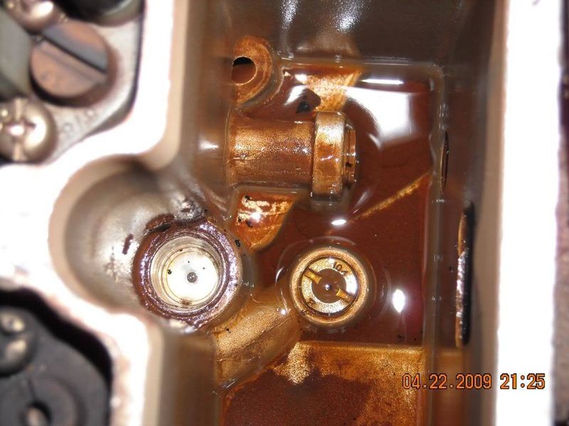

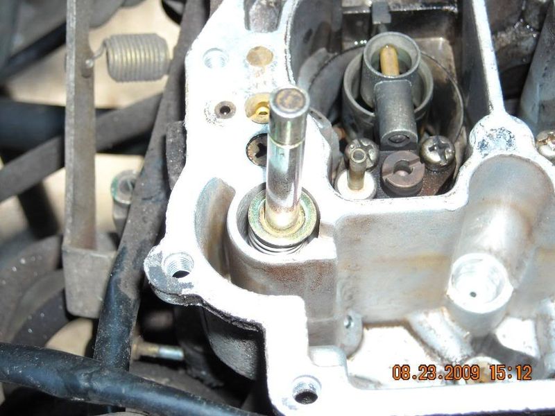

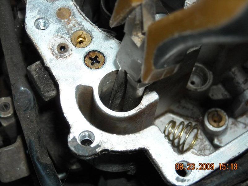

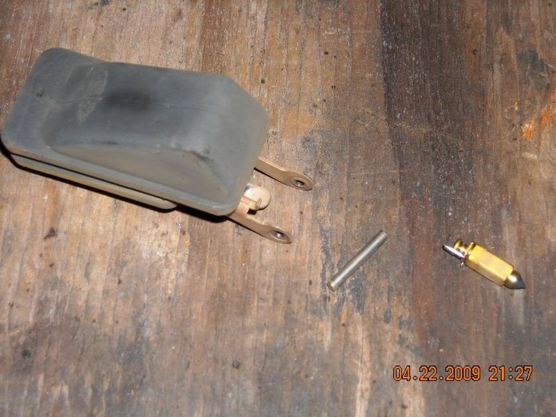

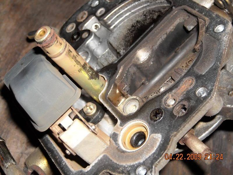

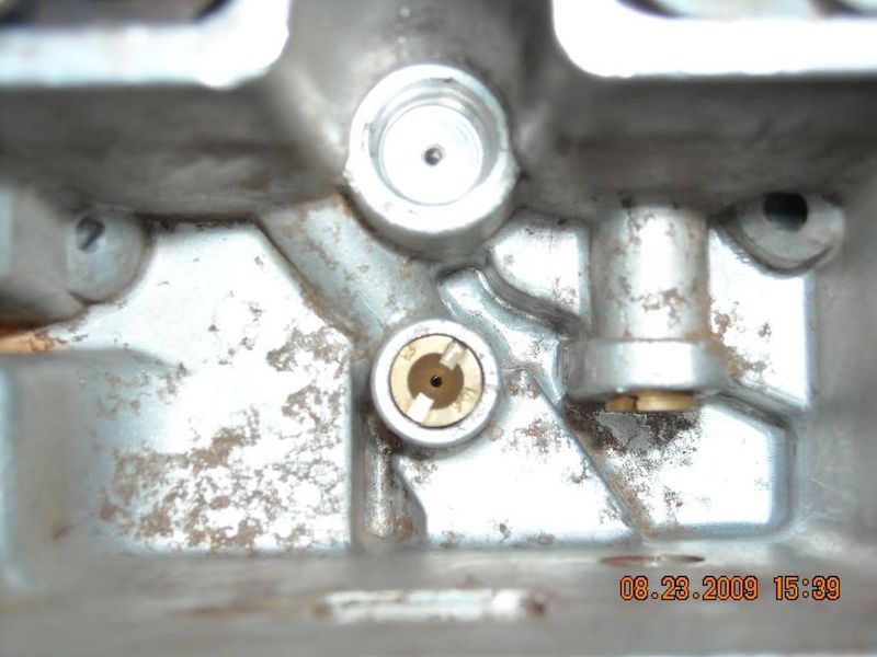

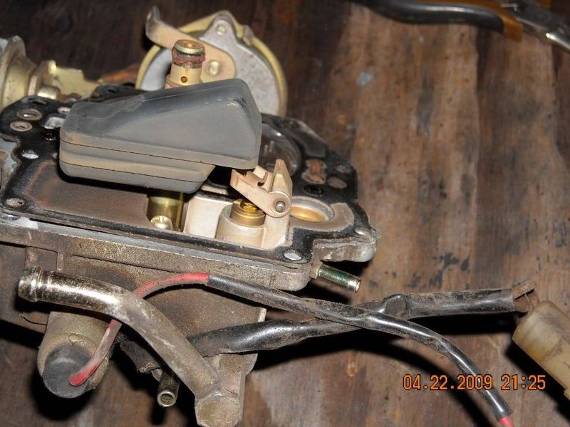

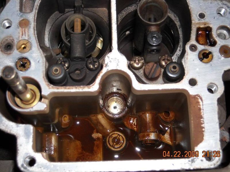

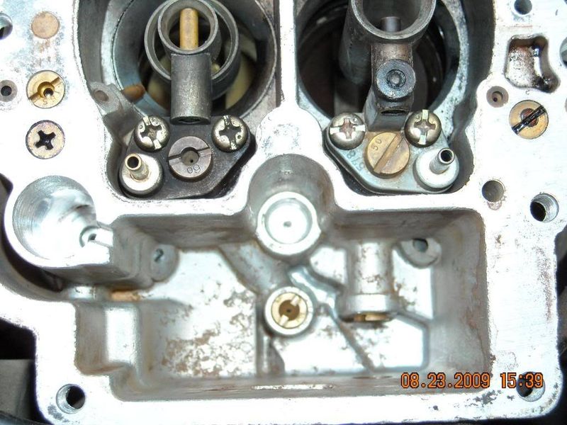

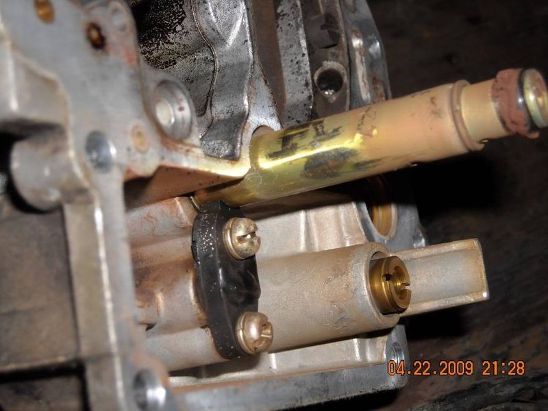

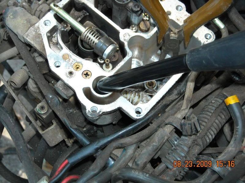

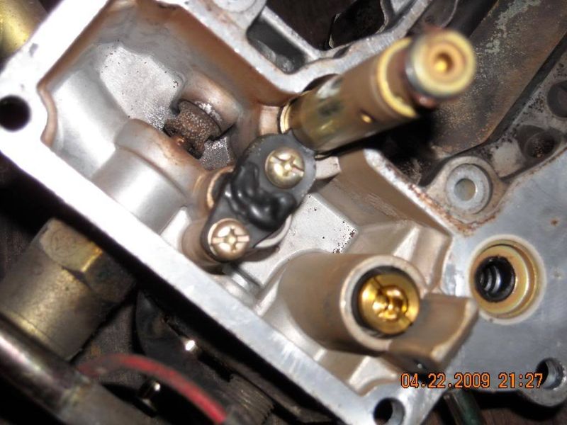

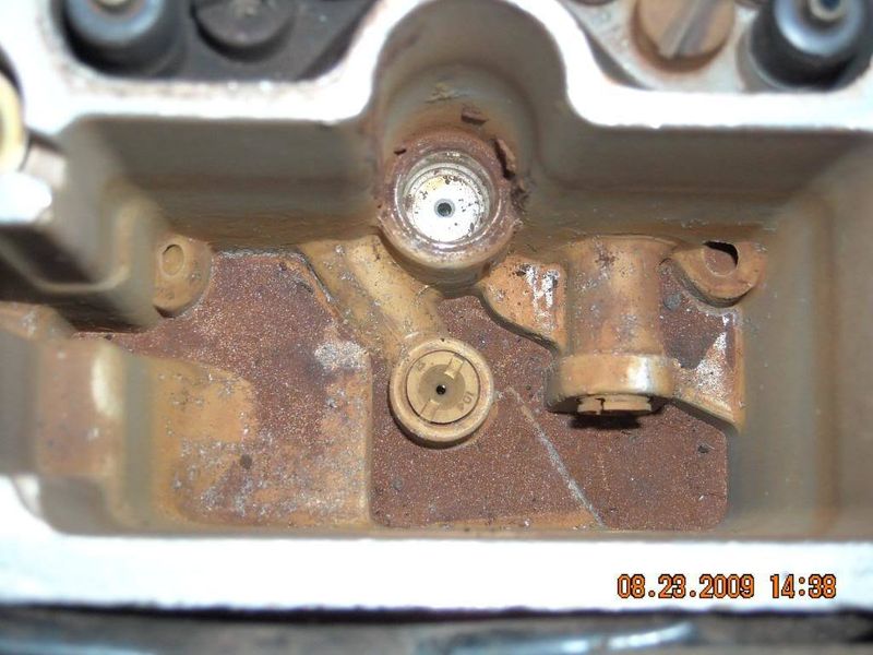

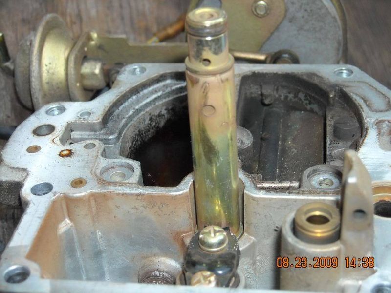

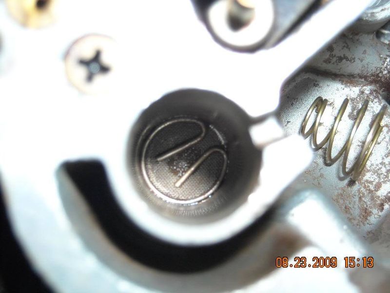

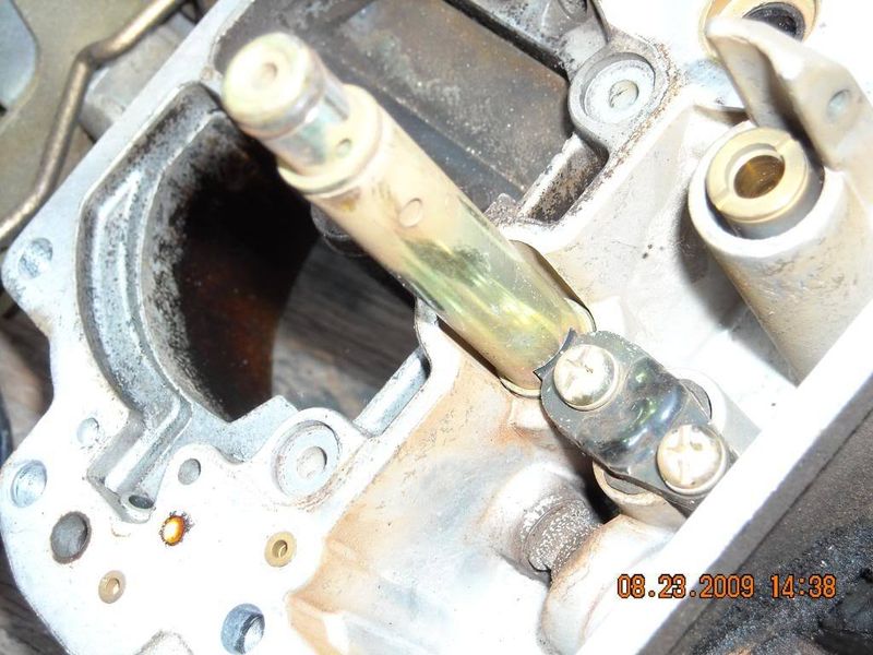

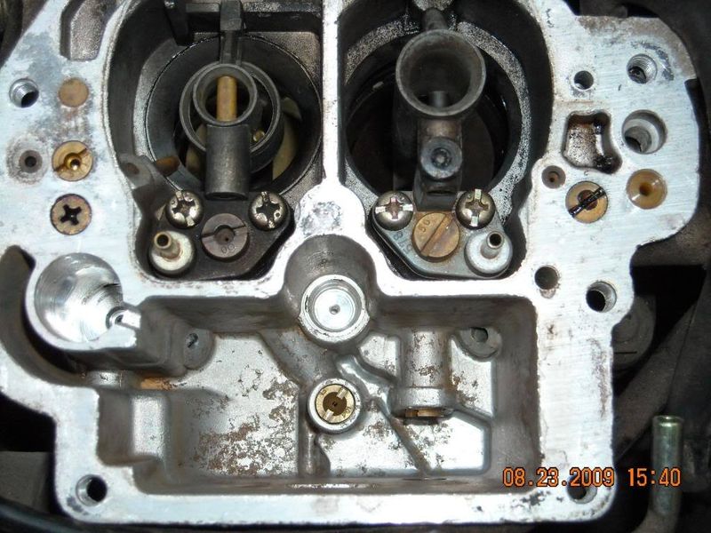

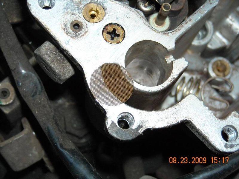

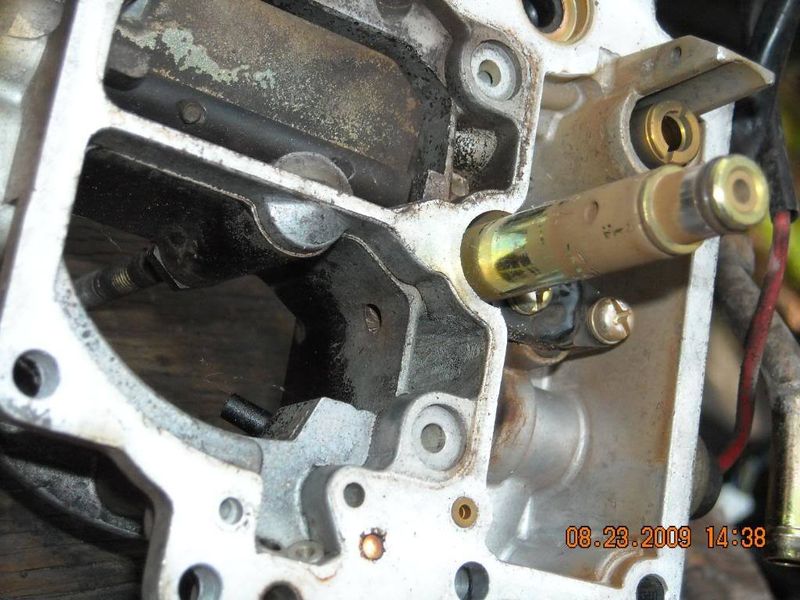

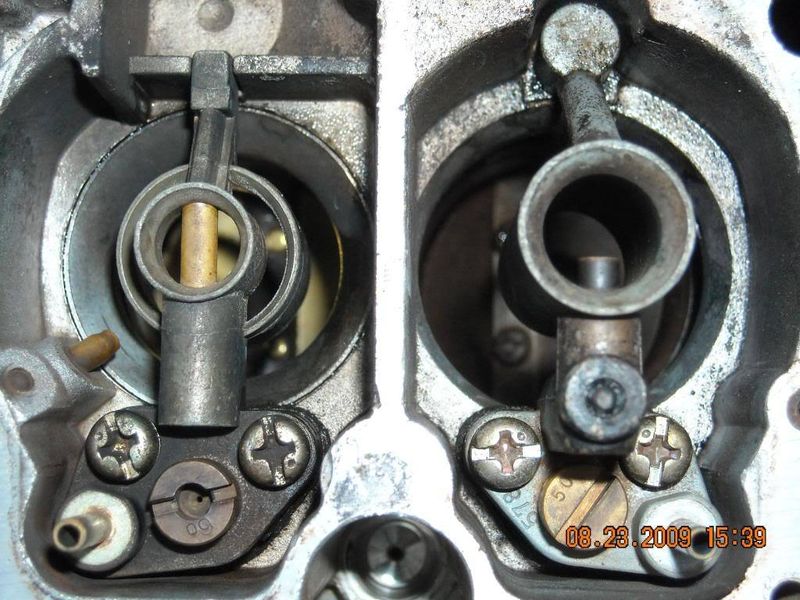

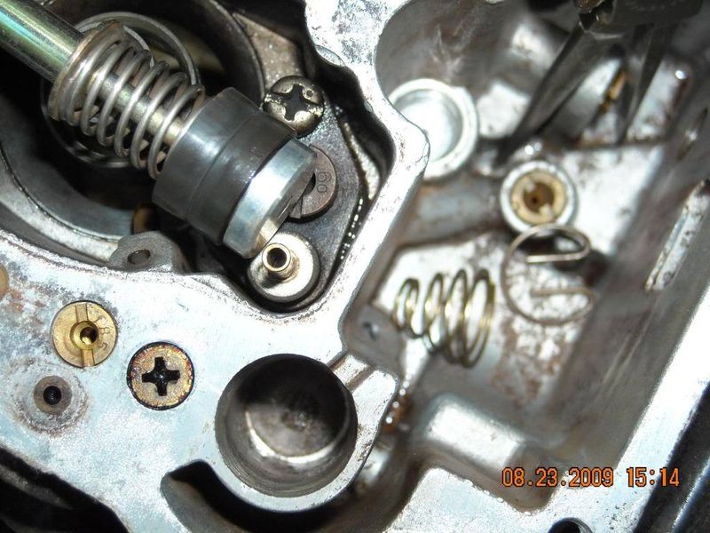

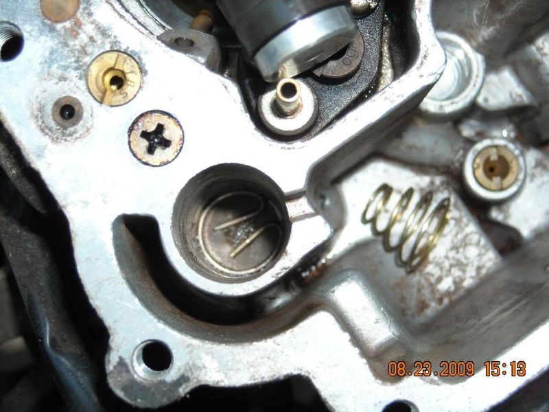

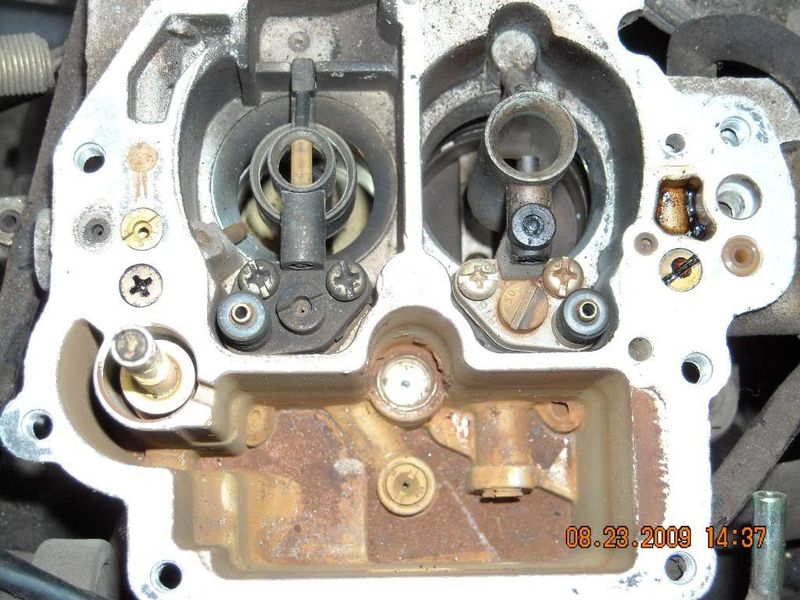

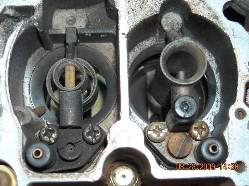

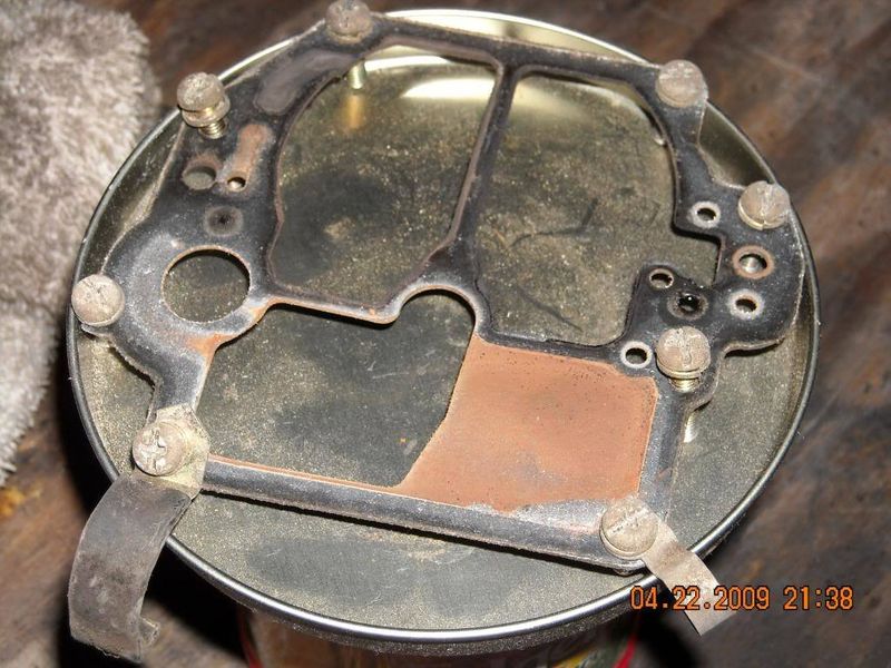

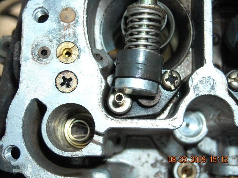

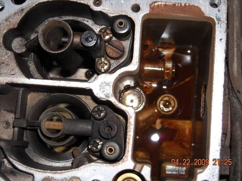

I am going to post some pics of a 1988 2.2 carb that I cleaned the rust debris out of (from a rusty fuel tank) and got it going again a couple of years ago, just so you can see if you remember if yours was missing anything in the float/fuel bowl area.
Maybe one of the pics might show if yours was missing something.......it's worth a shot anyway.

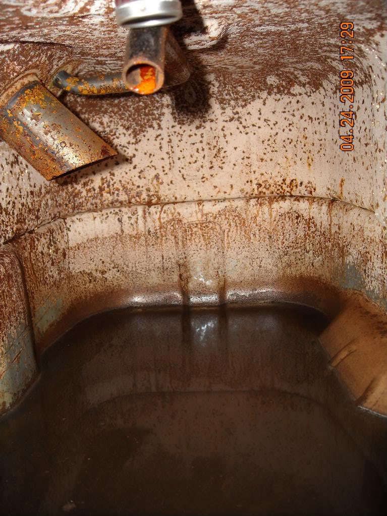

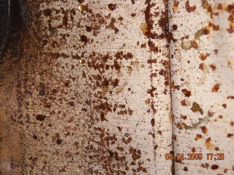

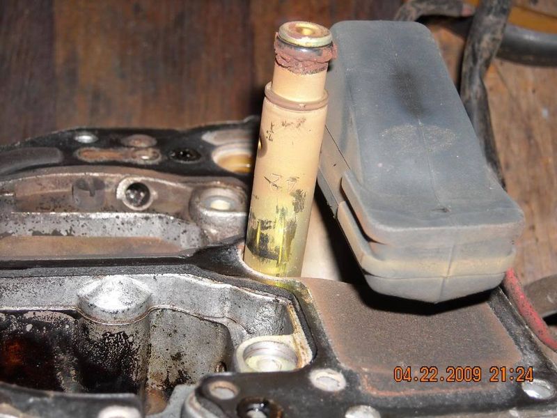

Wanna see the inside of the gas tank too?
OK!
Wow, Earl is the man!

LOL, Thank's Baha!
Hopefully he can see something here that might help him! Probably going to have to pull the lid off of the carb again though.
87forever's avatar
87forever
Nice break down earl as most of that is obvious to me being my half tear down on mine.Hopefully this can get this b back to normal.And pics are solid as usual!!! Good stuff

jesus that tank is a rusted mother trucker
