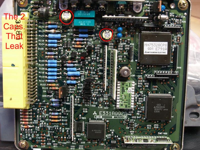

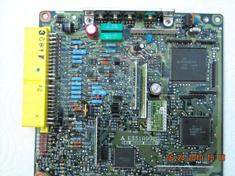

Both of the 2 EFI Mazda engines, the 2.2 and the 2.6, can have ECU issues. There are 2 capacitors on the ECU board that will leak (If it is a factory ECU and the capacitors have not been swapped out) and start etching the traces and other components on the board.
What I would do is disconnect the battery, unplug and remove the ECU, it's located behind the passenger side kick panel, and remove the cover and have a look at the board.
If you have some leakage from those two caps, then it is time to send it to a company like AvPro and have them fix it, or look for another ECU........I would have yours fixed though.

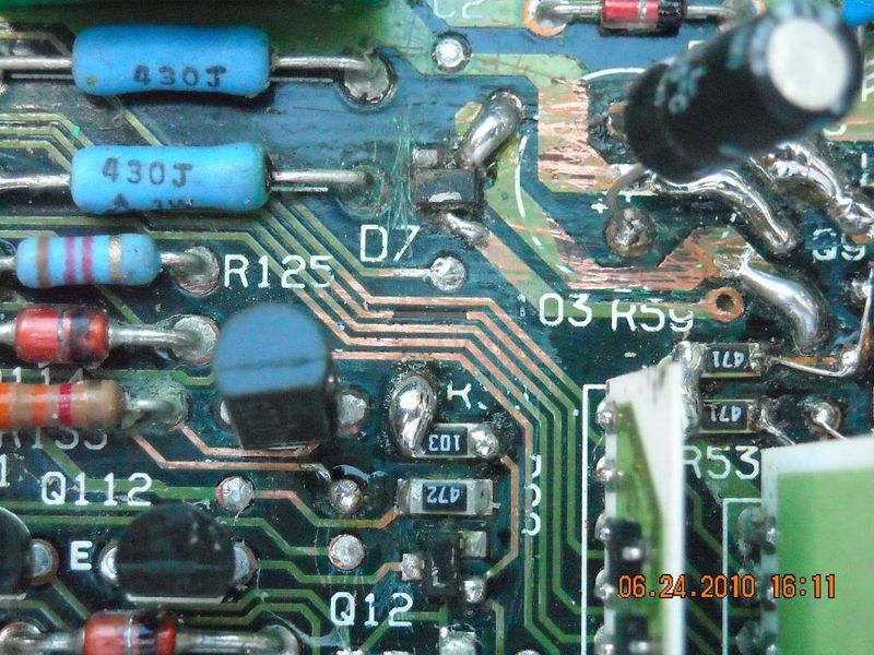

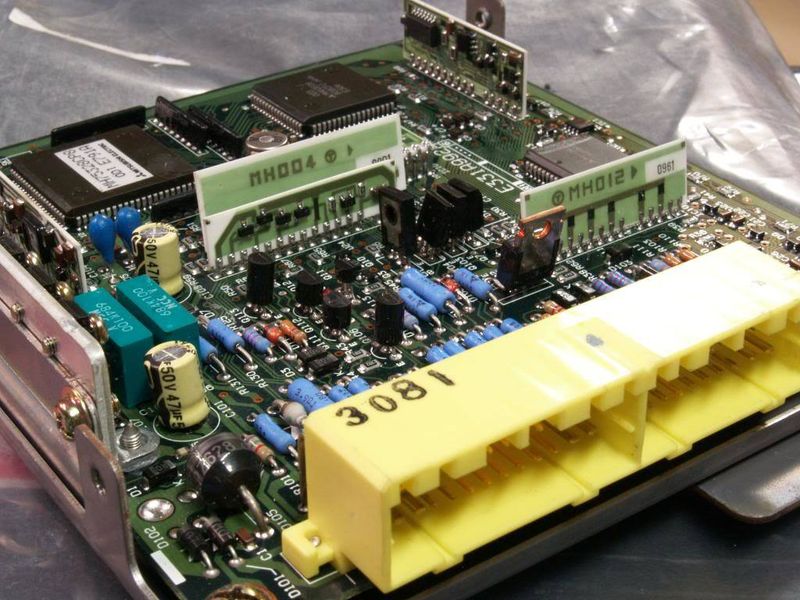

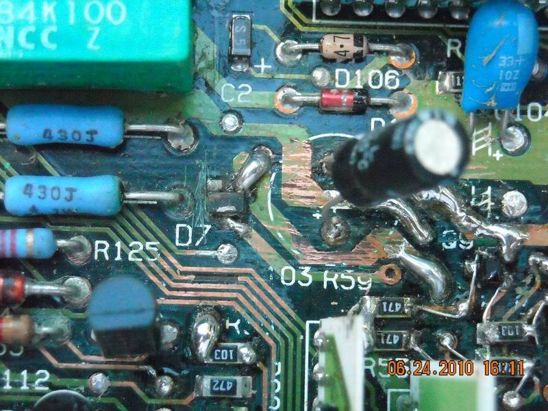

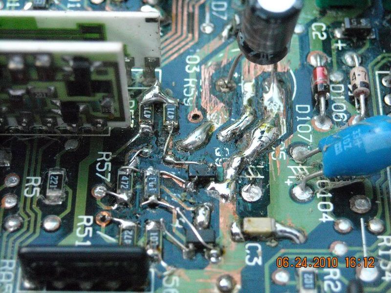

Here is a few pics of a B2600i computer, but the one for the B2200 is very similar.
Here's one that was in my truck when I first bought it.......it worked, but the MPG was not too good. I got lucky and found a good one at our local JY and put it in my truck and I picked up at least 2 MPG on in town driving! This ECU had leaked and the board was hurting!!
The company that "fixed" this one was NOT AvPro by the way! They kinda butchered this I think......
Bottom line........look at your ECU board BEFORE you throw any more money at the truck!
If your not sure of what it looks like......take a few good CAMERA pictures, and post them here for us to look at.
Let us know what you find out.

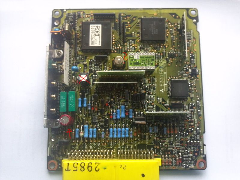

geospine's avatar
geospine
Thanks for the info and pix Earl,
Before I removed the ECU I was getting error codes 2 and 17. I am not sure what 2 is but I think 17 is ECU failure so you may be on to something.
The black thing with the x on it must be the failed cap. then because there was red goo around it (near the # sign on the board) which I unfortunately scraped off before taking the picture.
Should I also replace the red cap. indicated by the arrow?
How much does AVPro charge for this kind of job?

axel breaker earl's avatar
axel breaker earl
AvPro is going to be around $100.00 or so I would imagine. Your board looks pretty darned good, so you might want to try replacing those 2 caps yourself and see what you've got after that.......one's red, and the other is black.......the silver thing is a transistor I think.
Look closely to make certain that the goo that you scrapped off didn't eat through a trace on the board, and I would clean that area with a small brush dipped in Windex or similar cleaner that will remove any of the acid traces from the failed capacitor.
