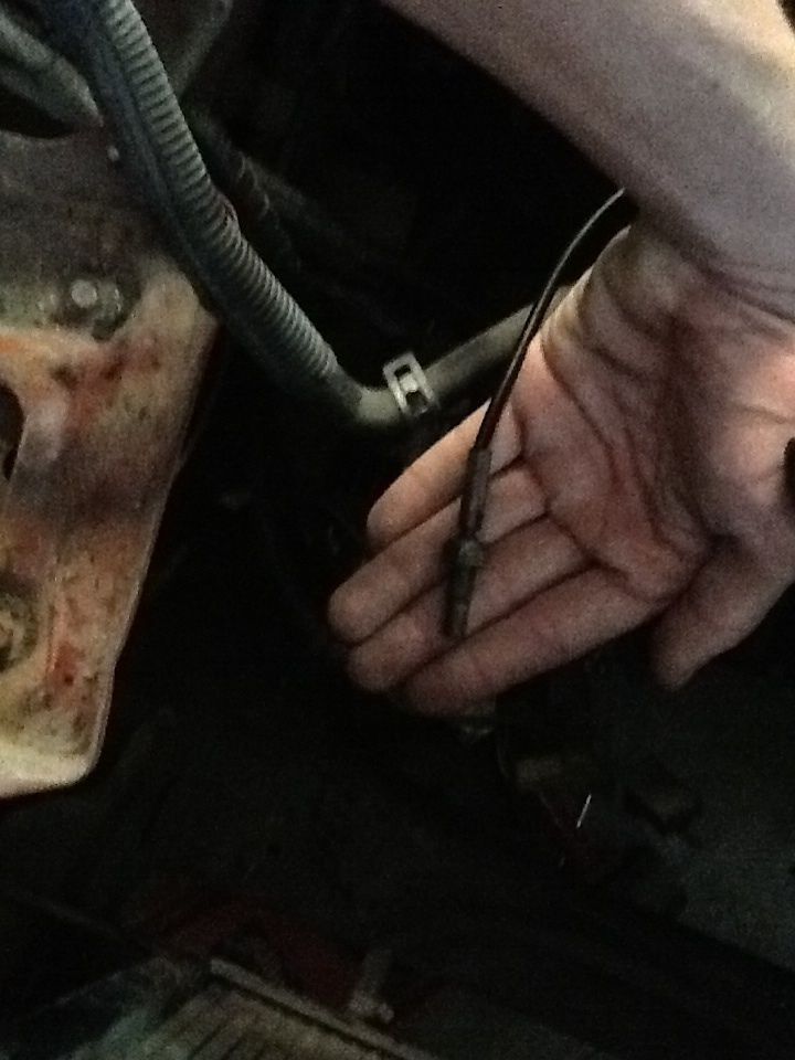

I'm finishing out swapping a 2.2l in my 87 B2000. The 2.2 is from an 89. I'm hooking up the wiring on the passenger side and I cant figure out where this plug/wire thingy goes.
I think it screws into the block somewhere, but I can't tell. I even looked at the old block to try to see where it went.
I did take alot of pics but none of them show this thing anywhere.

your image does not show up. I think you have to click "public" in order to share it.
low-n-slow
thanks, should be fixed now.

Now it shows up.....That is the temp sensor for the gauge pod. It goes in the upper radiator hose neck. It is a aluminum curved neck. Should find the hole there. Good luck.

Under the upper radiator hose, temperature sender for the dash gauge.
Earl has a photo with the location circled.

Awesome, found it right away. Thanks alot!
