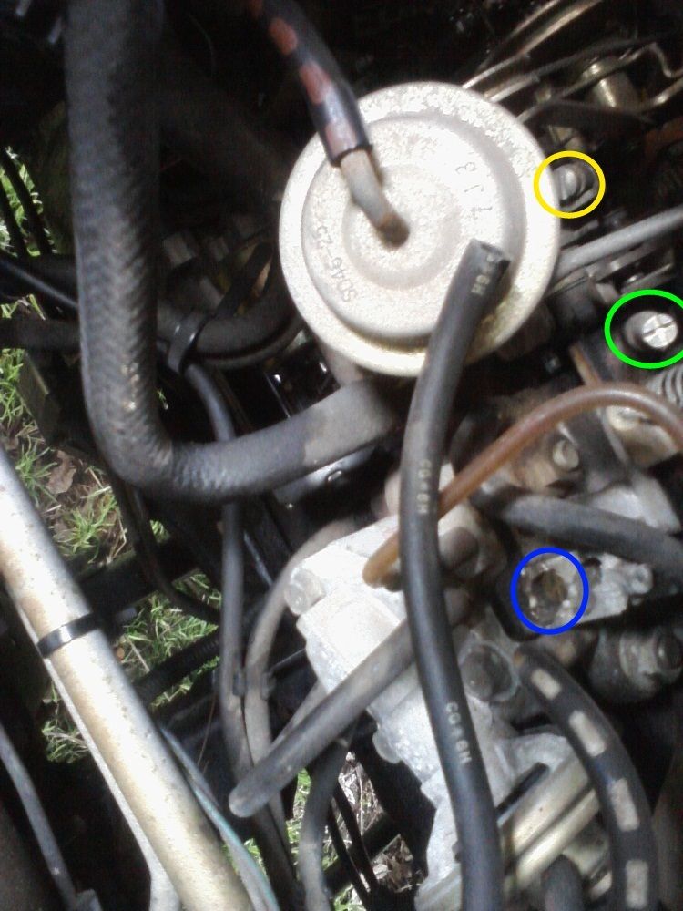

I attached a picture, the only screw I turned that seems to be doing anything is the green one, blue one doesn't seem to do anything. And the yellow one looks like whatever it's on is loose, I sometimes see it like kick back and forth and sometimes just shakes around when the engine is idling a little rough. Besides the green screw I haven't really messed with it much since I don't really know what each one is for.

Blue is your idle mixture adjustment. You need a dwell meter to watch the computers command of the air/fuel ratio to properly adjust it. It will affect your emissions at idle if it is off far enough. The green is your regular idle speed adjustment, don't know off hand what the correct idle speed is, but IIRC it is somewhere around 700-800 RPM at idle warmed up with all accessories off. The yellow screw I believe is the cold idle speed. So when the truck idles up when cold with the choke, that is when you would set that screw. Someone correct me if I am wrong.

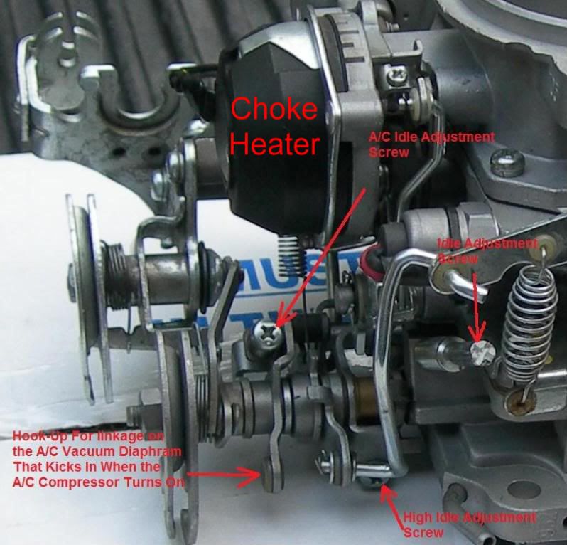

The yellow is the A/C Idle Adjustment Screw.......it helps set the idle slightly higher when the A/C compressor turns on. That vacuum diaphragm right near it with the vacuum hose hooked to it will receive a vacuum signal when the A/C comp. is turned on and it pulls the throttle linkage by however much that adjustment screw lets it........now, if that screw is tightened too much, when the A/C comp. comes on, the idle will rev up, then down, then up, then down.....back and forth. All you have to do is loosen the screw a bit and it will quit revving up and down and stay at a constant rpm. If that screw is too tight, the vacuum diaphragm isn't large enough to hold the throttle opened that much so it will pull and release, over and over again, causing the idle to rev up and down.
You want to adjust that screw while the A/C compressor is engaged and on.
Here was a well used/known pic on that other Mazda truck forum!

I know that on the J.Y carburetor I bought, I removed the roll pin and then I counted the # of turns.,, for a total of 2 and 1/2 turns out, on the blue screw that earl circled for you.
