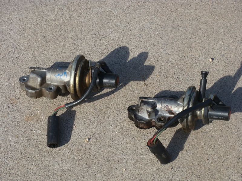

I was really thinking that would help since it was so gunked up. I can't seem to keep he running now. My carb linkage is all good and everything movs very smoothly, and now that I got that coke wire hooked up it helped quite a bit before I jacked it all up with the egr. Not sure if I messed something up or not, but I am going to take it off again and make sure that everything is still good to go. If that pintle doesn't move freely and I can't free it up I'm just going to snag a new one off of ebay. EGR's are 230-250 at the parts store, but new ones are running between 80-100 on ebay. I called over to the local pink-n-pull, but the only thing with a mazda 2.2L they had some guy had just snagged the egr off of it yesterday. Hope i can get it all going so i can use this thing as a daily without sinkin too much into it. I just realzed after typing all of this that I probably made a bonehead mstake and after I got all of the carbon gunk out of it i sprayed it down with carb cleaner and I'm not sure that I got it all cleaned up before re-installing it....So I'm out to take it off again and clean it up again, I'm going to assume that there is no more gunk since I got so much out before, but I'm pretty sure I'm gonna get a little of the juice from the carb cleaner. We'll see if I'm a bonehead and I will keep you updated...
Cusser's avatar
Cusser
I've got two working EGR valves from B2200, PM me with offer if interested. Hint: considerably less than Ebay !!!
That's Permatex Aviation sealer on the EGR valve on the right (what I use with a previously-used EGR gasket), comes off readily with alcohol.
