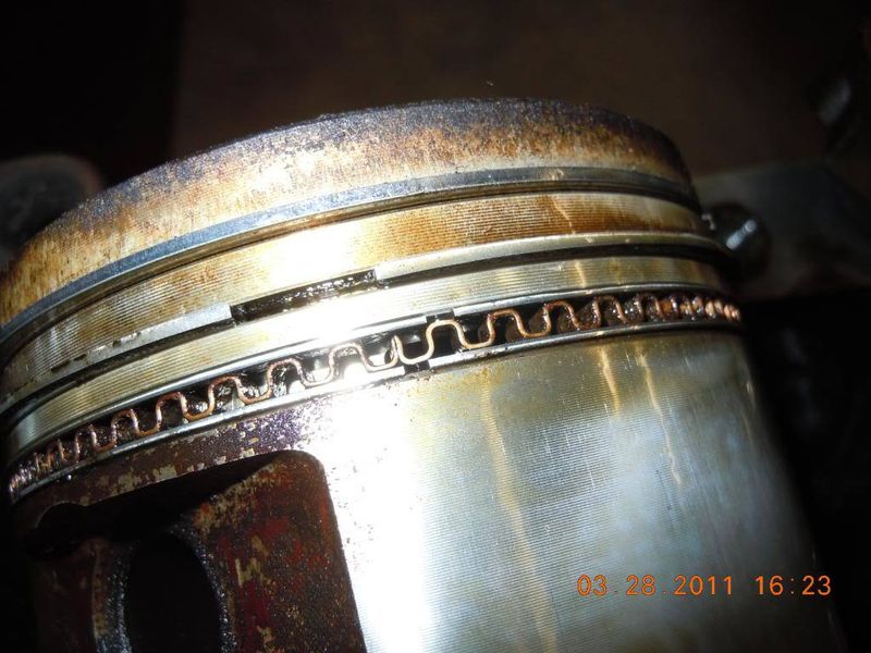

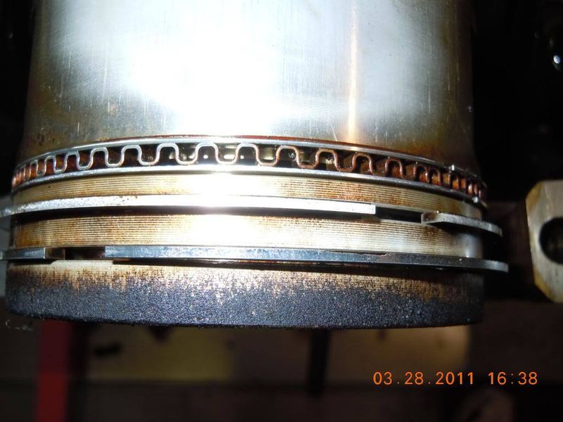

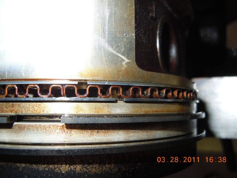

Here are a few pics I have taken showing how the rings are just too gunked up protrude from the grooves like they should.
This engine was not bad at all really....I have other pics (I'll find them and post the also later) that the compression rings were even bound up some.....look at the oil rings (with the spacer between them) on thes pics though.....this motor is now in my little red truck and it doesn't smoke any at all.
